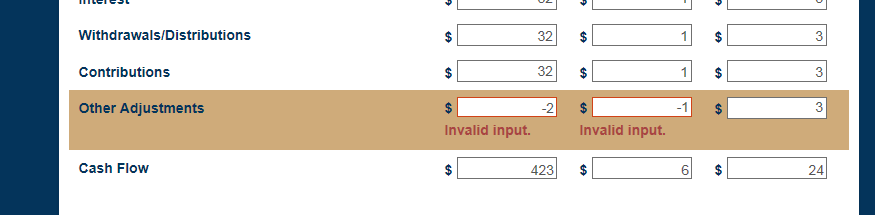

is it possible to enable negative numbers for the currency field?  I am looking to use this field as a positive or negative number for other adjustments.

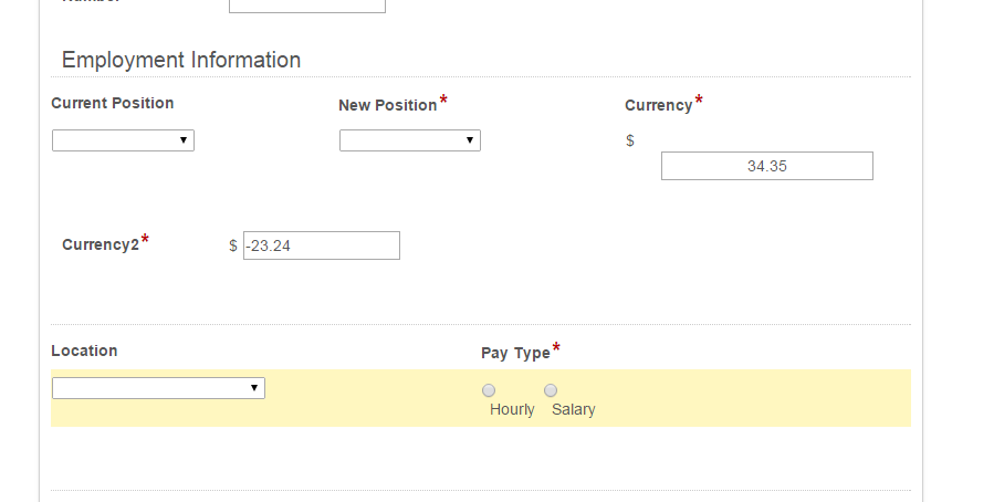

Works for me. Make sure you don't have some custom javascript validating the field.

Chris,
thanks for the suggestion, as I do have a jquery to automatically add commas after every 3 digits.  Is there a workaround to have both working?
 $('.currency input, .table1c1 input, .table1c2 input, .table1c3 input').attr("pattern", '^(\\d+|\\d{1,3}(,\\d{3})*)(\\.\\d{2})?$');
  $('.currency input, .table1c1 input, .table1c2 input, .table1c3 input').on("change", function () {
    $(this).val($(this).val().replace(/(\d)(?=(\d\d\d)+(?!\d))/g, "$1,"));

Hi Tommy,
You should be able to accomplish that by simply allowing for a minus symbol in the regular expression.
So line 1 in your code becomes
$('.currency input, .table1c1 input, .table1c2 input, .table1c3 input').attr("pattern", '^([-]?\\d+|[-]?\\d{1,3}(,\\d{3})*)(\\.\\d{2})?$');
And that should do the trick. Hope this helps!
