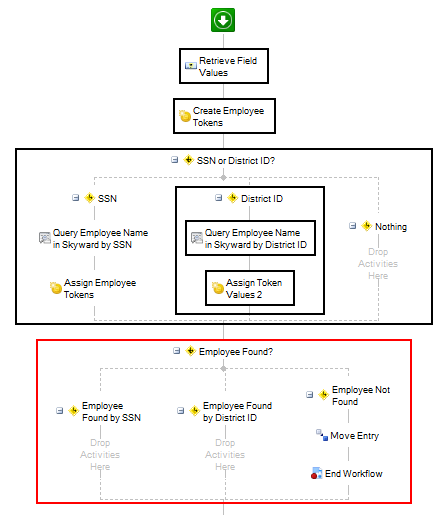

I have a workflow that is setup as follows:
When a document is processed and has a SSN it goes down the SSN path. When it then hits the "Employee Found?" section, it processes through correctly because a result was found from the "Query Employee Name in Skyward by SSN".
However, when a document is processed and has a District ID, it goes down the District ID path, but when it hits the "Employee Found?" section to see if a result was found from the "Query Employee Name in Skyward by District ID" it gives an error message of "String was not recognized as a valid Boolean." It doesn't make sense because the "Employee Found by District ID" path has a single condition as follows:
Does anyone have any ideas why I am getting this error message?

Hello Blake,
I was able to reproduce your problem. For me, it is due to the "queryemployeenameinskywardbyssn_results found" not being created since the first branch in the first conditional doesn't run. Then, the "Employee Found by SSN" will try to evaluate a non existent token as a Boolean which results in the error for me at least.
One way to check if this is the case is to see if there is a warning from workflow stating that the token stated previously was not created.
replied on December 7, 2015
Winston, that was indeed the problem. I tried a test by adding a conditional sequence into each the SSN and District ID paths in the SSN or District ID? decision. After doing that, the workflow worked correctly.
I would have expected the Conditional Decision to see that there was not a value for the token and to move onto the next branch instead of terminating.

Also instead of a conditional sequence, you could duplicate the original conditions in "SSN or District ID" into the conditions for "Employee Found?" which would check if there was an SSN or District ID.
Blake - In this case the logic performed as expected and threw the error _because_ the determining token was not initialized.  I think you would have a difficult time troubleshooting a conditional sequence if you had it ignore the leg if any determining tokens were uninitialized.
Going back to the earlier post; one way to avoid an uninitialized token is to explicitly initialize the determining tokens at the top of the workflow and change their value as necessary later in the workflow.

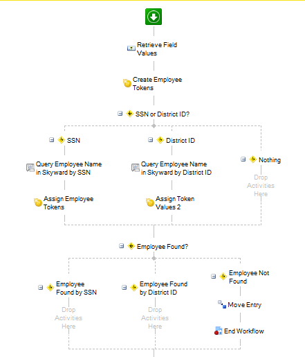

Here is a screenshot of the workflow process for one of the instances that is failing and also a screenshot showing that results found comes back as true.
