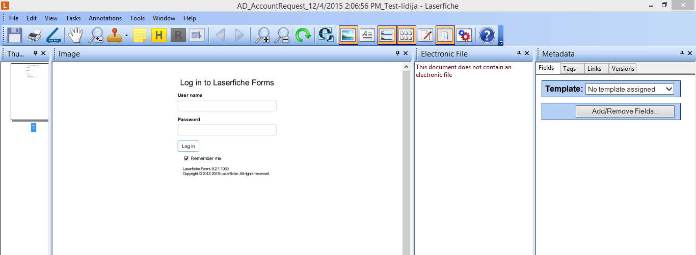

Hi, we have an odd situation- when our Forms are saved (pdf of tiff, template or no template) it saves the login screen instead of the form! This did not used to happen, all that happened was that we added https to the forms site.
See attached picture at the bottom of the post. Also, the forms server error log displays a warning:

Hi all, we have a resolution! I will post it in case anyone else has the same issues. Our VAR, Nick Upton, figured it out.
Like I mentioned in my OP, we had recently switched to https (we are not in production env yet so it was alright to change settings), then realized that forms are saving to the pdf of a LF Login Screen (weird!).
Go to your Form Config page (https://yourURL/FormsConfig),  under Forms Server tab, make sure to check Use SSL Connection on Primary Forms Server URL.
Then go to your Workflow server, open the Workflow Administration Console, localhost>External Objects>Web Services  and make sure your service URL is updated to include https.
If you have any workflows that are initiated in you Process Modeler, go to those workflows and on you Retrieve Form Content Action check the server settings - they should reflect the settings in your Workflow Administration Console.
Thank you Nick and thanks to James and Ege!
