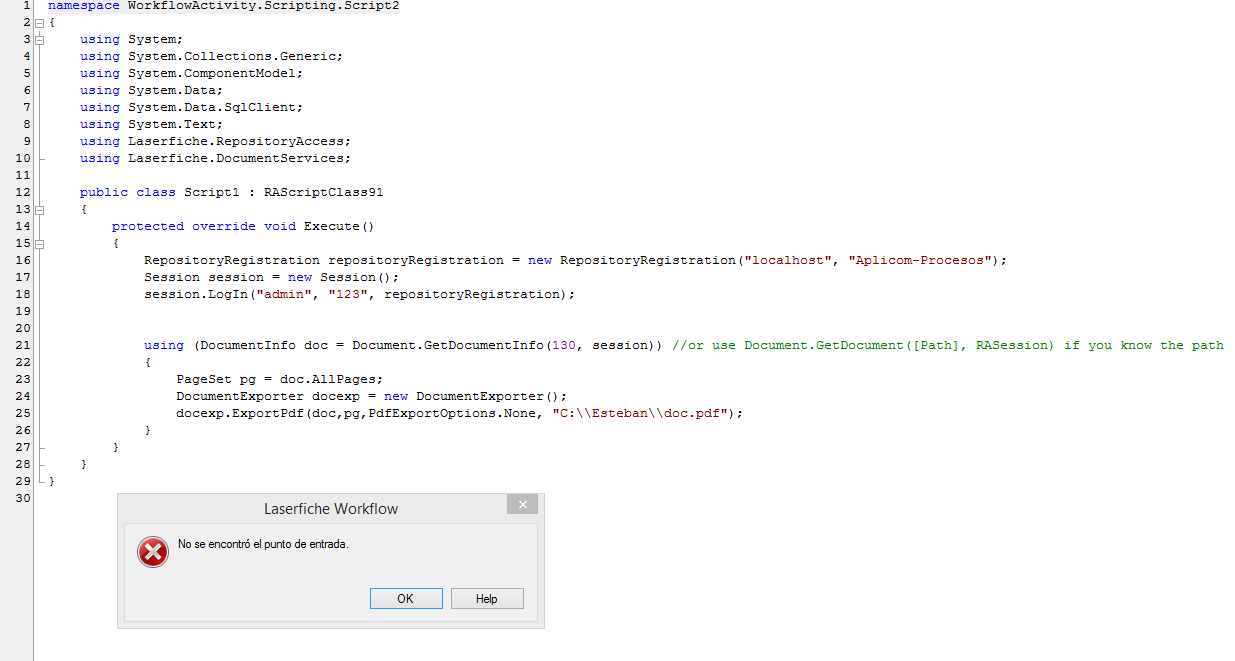

replied on December 2, 2015
We trying with this code  but it shows the following error
"No entry point was found" any idea?
replied on December 2, 2015 • Show version history
If you want to use it that way, use this code: (Make sure that entryid exists in Laserfiche as well)
using System;
    using System.Collections.Generic;
    using System.ComponentModel;
    using System.Data;
    using System.Data.SqlClient;
    using System.Text;
    using Laserfiche.RepositoryAccess;
    using Laserfiche.DocumentServices;
    /// <summary>
    /// Provides one or more methods that can be run when the workflow scripting activity is performed.
    /// </summary>
    public class Script1 : RAScriptClass91
        /// <summary>
        /// This method is run when the activity is performed.
        /// </summary>
        protected override void Execute()
            // Write your code here. The BoundEntryInfo property will access the entry, RASession will get the Repository Access session
            using (DocumentInfo doc = new DocumentInfo(130, RASession))
                PageSet pg = doc.AllPages;
                DocumentExporter docexp = new DocumentExporter();
                docexp.ExportPdf(doc,pg,PdfExportOptions.None, "C:\\Ricardo\\doc.pdf");
Also, it is not necessary that you create a new session. Workflow creates the session in the object "RASession" which uses the workflow connection profile.

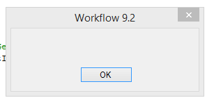

it shows this error
it can't find this document
Any idea?
I'm confused, your screenshots and code keep switching between WF 9.1 and 9.2.
When exactly are you getting those errors? If it's when you test the script, did you specify an entry? The Error List in the script editor should give you the line where the error occurs.

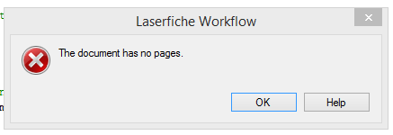

and is shows this error
Your script works for me for documents with image pages. Just to double-check, your document ID 272 is an image document, not an TIFF image imported as an electronic document, right?
Edit: The only time i get the error you have above is when the document contains a single empty page. If the document has image pages, the export works. If the document is an electronic document with no pages, i get "Object reference not set to an instance of an object".
