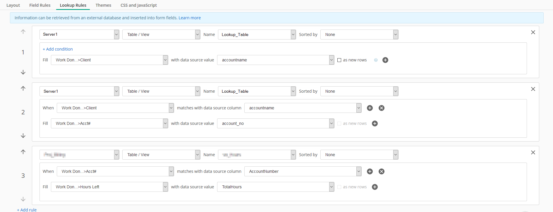

Forms lookup fields have become very slow to populate in version 10. Version 9 would take a second or two max. Version 10 now takes anywhere from 20-40 seconds to load the drop down. We are querying a view to populate a drop down list, no criteria.

Can you provide a screenshot of the form and the lookup rule configured? How many options in the dropdown list?

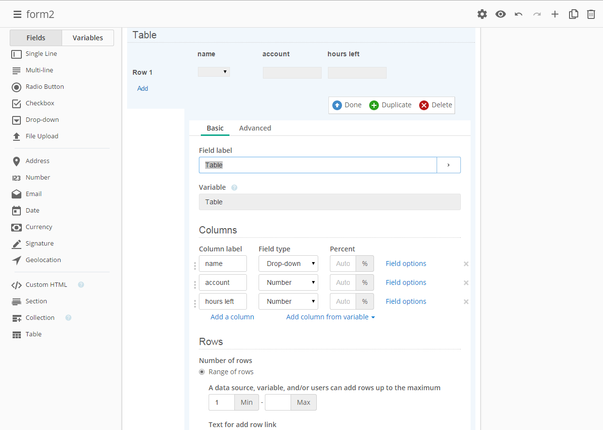

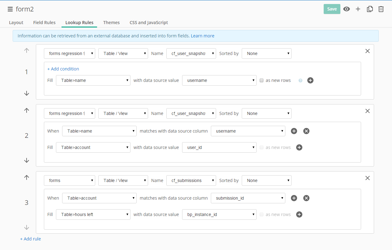

I configured lookup rules following yours, but still no issues found. Can you please provide me a screenshot of your form? Maybe other configuration affects. Here are screenshots of my form and lookup rule, also add a video of form submission, please take a look.
http://screencast.com/t/nQr1twDRE3
