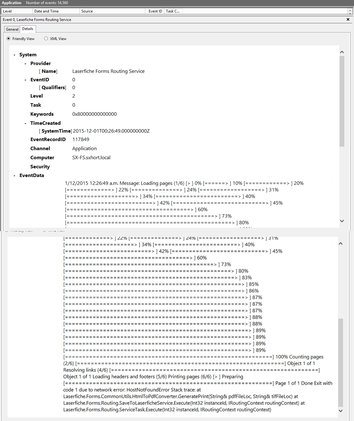

I have a form "Timesheet" which is getting an error from event viewer and suspends in Forms during the "save to the repository" process every time i run it, the form can contain no data except for one required field. this is the event viewer error.

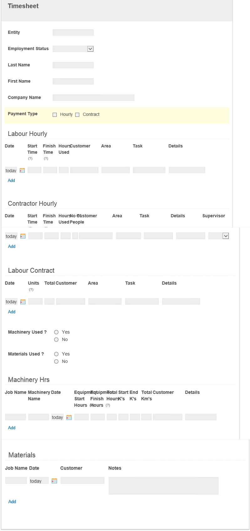

This is the whole form, which does contain about 6 db lookup rules and 9 field rules.

Above are a few links that can help, but I believe this error specifically comes down to iis bindings with https and making sure that you have the "use SSL" option selected in FormsConfig. This is caused by wkhtmltopdf not able to load the forms url. Check to make sure your forms server url is set correctly.

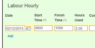

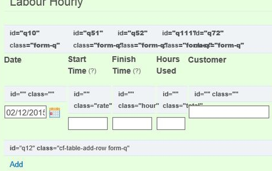

Here is the JavaScript i'm using and here is where its used in the form, what is does is allow me to input times in 24 hours format, calculate the hours worked and then total the amount as a single or double digits.
