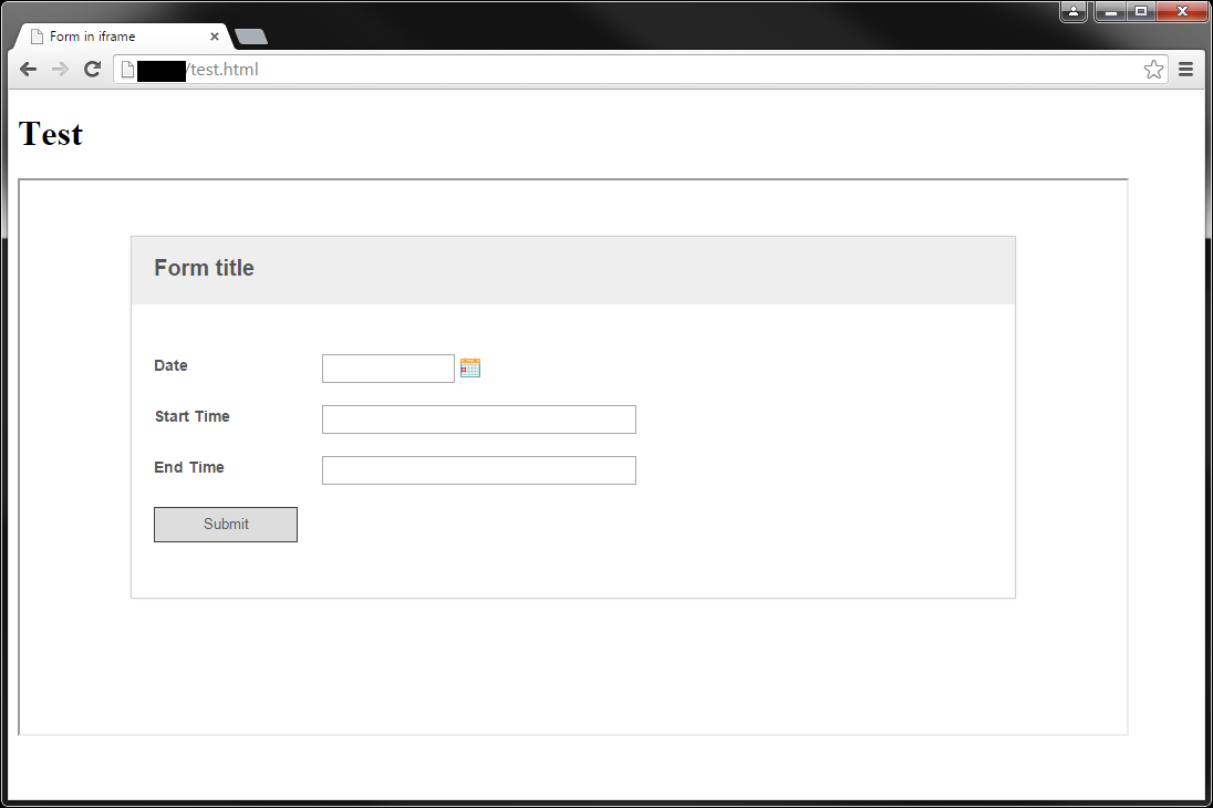

I wasn't able to recreate the issue using a generic form and html page
<!DOCTYPE html>
<html>
    <head>
        <title>Form in iframe</title>
    </head>
    <body>
        <h1>Test</h1>
        <iframe width="1000" height="500" src="http://MyServer/Forms/swjQf"></iframe>
    </body>
</html>
Can you provide additional details regarding your setup? Also, if you perform a similar test as the one above, is there still an issue?

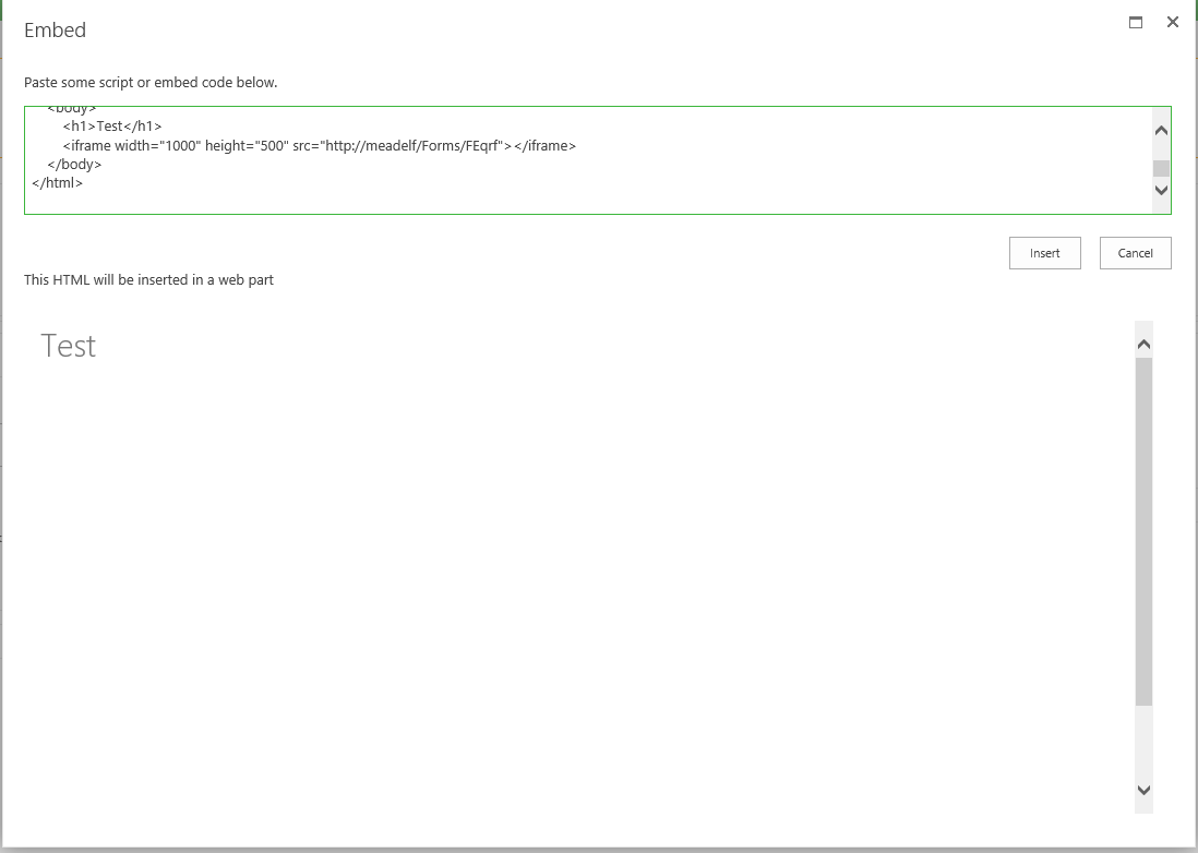

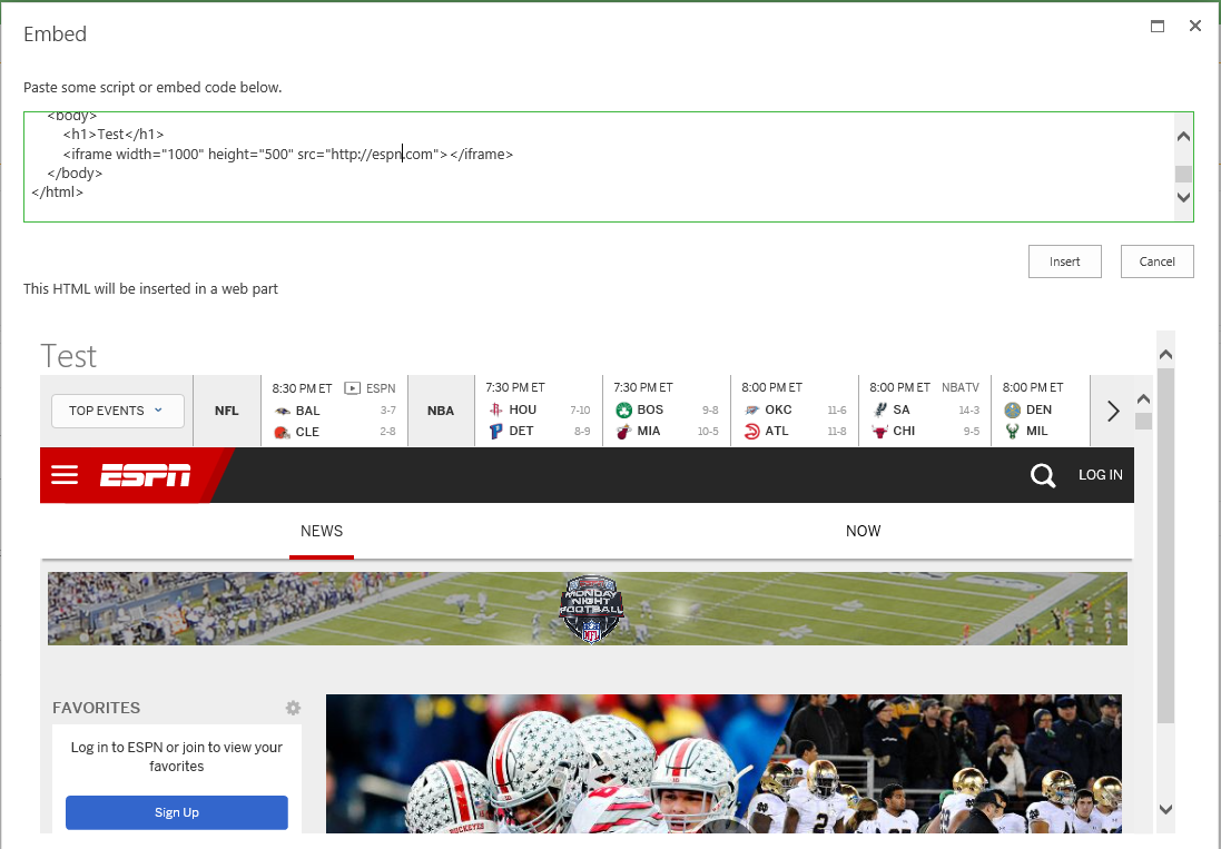

replied on November 30, 2015
Hello Alexander,
I inserted your html from above into an embed code web part in Sharepoint 2013 and see the following. If I plug in a generic address such as espn.com, the page displays fine.  However, once I plug in the url of any form, I only get a blank white page.  This did work perfectly before performing the upgrade.  Checking the event viewer logs, there are no errors in the application, system, LFForms, or web server events that would indicate a problem.
