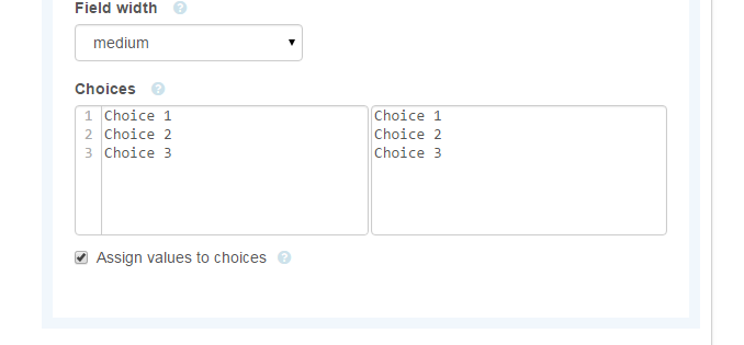

Also to use the value of the drop downs you'll have to make sure you've associated values with the choices in the form editor, as shown below:
Hope this helps!
