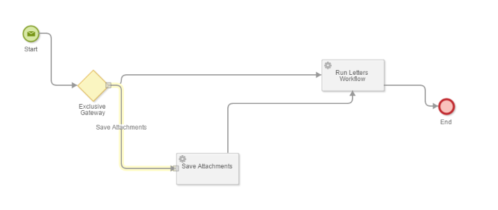

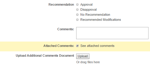

I have created a form that when submitted will run a workflow.  On the form is the option to upload a document - but this is not required.  In the instances when a document is uploaded I want to save the document in LF (and not the submission form) and then run the workflow.
I set up the process modeler with an Exclusive gateway that is supposed to save the document before it runs the workflow.
But it doesn't save the document or run the workflow and I get the following error:

replied on November 19, 2015

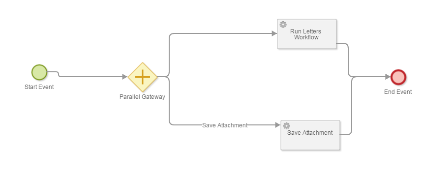

In this case you would want to use a "Parallel Gateway" and set the same conditions you have.

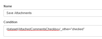

What is the setup of your Save Attachments task?
OK That helped - now it saves the attachment but it runs the workflow twice. - The workflow doesn't have a starting rule since the workflow is running it.  All the workflow does is take the data from the form and push it to a PDF form.

replied on November 20, 2015
OK with help from a friend I fixed my arrows and now everything is working as expected.  Thanks!
