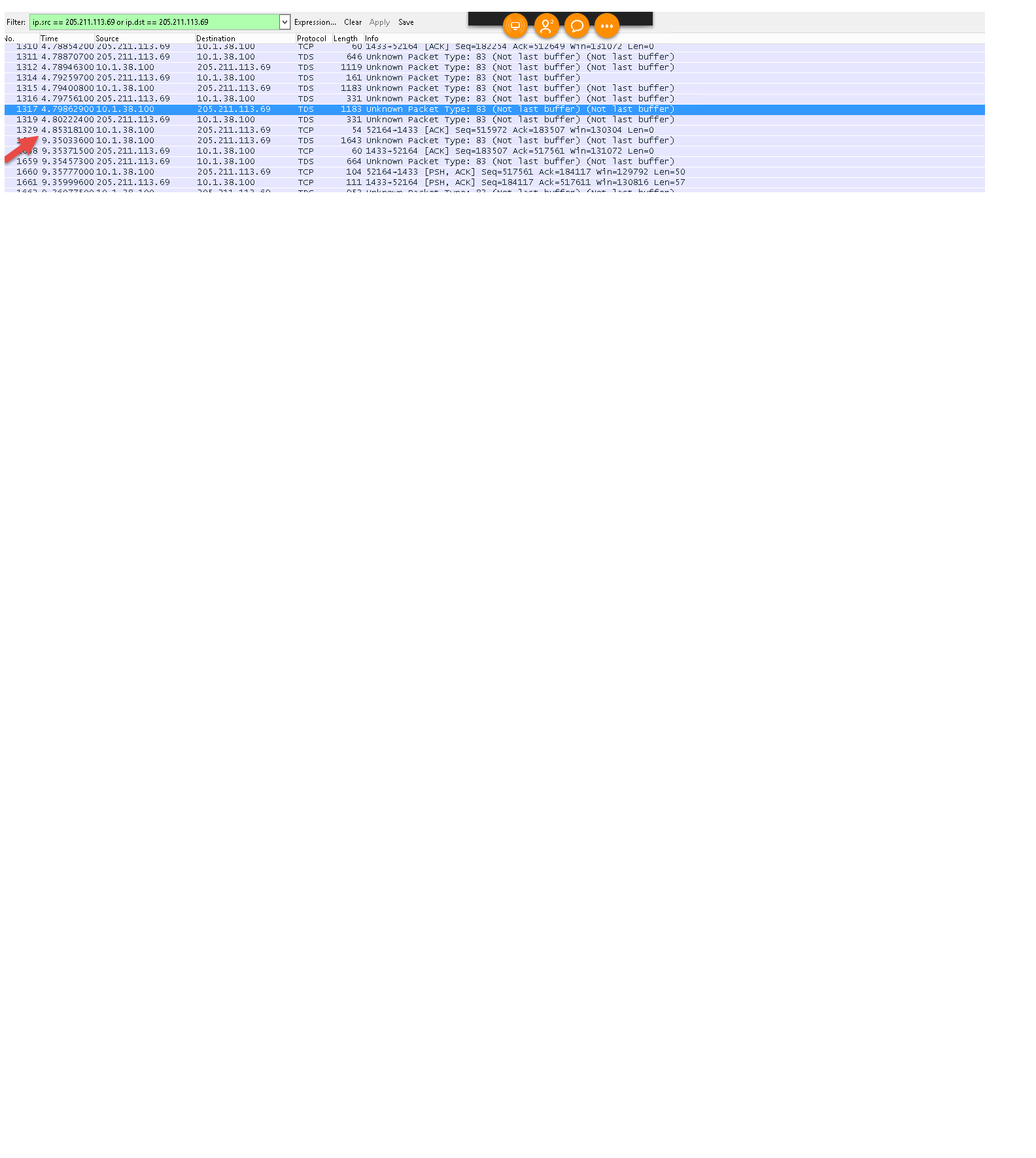

I setup Laserfiche Forms on a customer's DMZ (for the public portal).  Everything works fine but I have noticed a long (5+ second delay) before each public form loads. This does not happen with their local install, so it must be something with their DMZ install of Laserfiche Forms.
Attached is a Wireshark log demonstrating the delay between packets when the form is loaded. The full log is attached.
Have anyone seen this issue?  What can I do to resolve this?

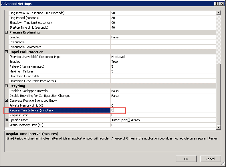

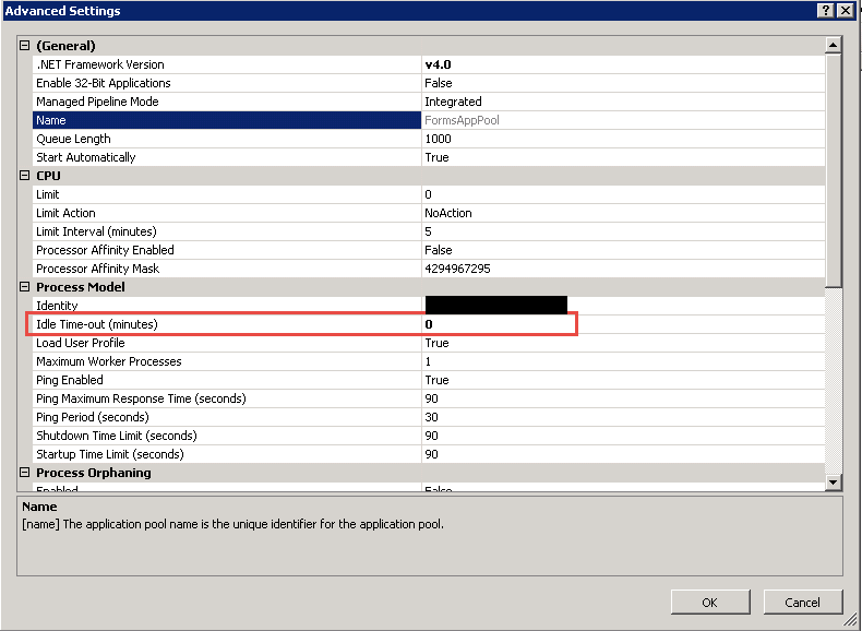

replied on November 17, 2015
If this happens on the first load of the form, it could possibly be the apppool timeout settings are set to the default 20 mins. We had similar performance issues with Forms, but after setting the apppool timeout to "0" in IIS, most issues were resolved. Go into IIS>Application Pools>[Forms App Pool]>Advanced Settings... Under "Process Model" there is a setting called "Idle Time-out (minutes)". Set that value to "0". Now there is another value under "Recycling" called "Regular Time Interval (minutes)" that is default to 1740. You can also set this to "0" but this is optional. I personally would set it to "0" due to first start up performance. Also may want to look into IIS Application Initialization.
Thanks!
I will test and let you know.
replied on November 18, 2015
Hi,
we tested this and it didn't help.  Any other suggestion from anyone else?
Thanks!
