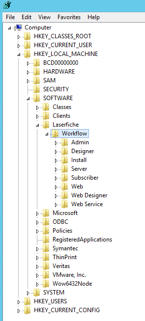

If you are swapping out the repository, you should stop the Subscriber and reset the ASN value in HKLM\Software\Laserfiche\Workflow\Monitored Repositories\<repo GUID>. Set it to 0 so the Subscriber will only process events going forward. Otherwise, depending on whether it's behind or past the ASN number in the real repo, it will either process events again or ignore events until the number saved in its registry matches the ID of an event coming in.
replied on October 13, 2017
Hi Miruna, I can't seem to find that registry key on the WF server?
This key was missing becuase the user the WF service was running as, didn't have rights to create the key.
