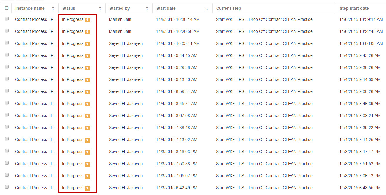

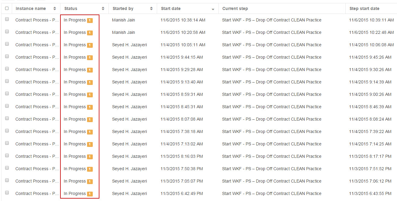

2. The Form instance status shows that workflow is still in progress. (see screenshots).

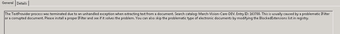

3. I see following WARNING message in the Event viewer at the time. - "The TextProvider process was terminated due to an unhandled exception when extracting text from a document. Search catalog: March-Vision-Care-DEV. Entry ID: 163700. This is usually caused by a problematic IFilter or a corrupted document. Please install a proper IFilter and see if it solves the problem. You can also skip the problematic type of electronic documents by modifying the BlockedExtensions list in registry." (see screenshot)

The TextProvider warning looks like it's coming from the search engine, so it shouldn't be related. If you're not waiting for the workflow to complete, then adding more activities and its duration shouldn't make any difference.
Your screenshot shows there are suspended tasks in the Forms processes. So there should be corresponding messages in the Event Viewer for those dates and times. It's probably best if you take this to Tech Support so the Forms team can take a closer look.
