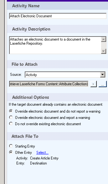

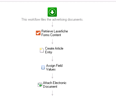

I am new to Laserfiche Workflow, I am trying to create a entry in the repository from the data off the submitted form. I am able to create the entry and get the data from the form however I am having issues inserting the attachment. When the workflow runs I get the entry in the repository with the template/meta data but there are no pages in it.

Can't tell without seeing the form, but it looks like your attachments come from a collection in Forms? That gives Workflow a set of documents, so you need to go through them with For Each Row and inside it, create the entry, set fields and attach the electronic document.

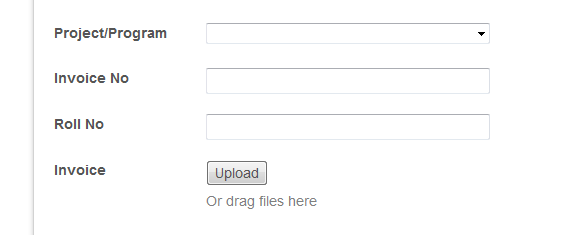

Thanks, I tried this with no luck on my end. I know I am do something wrong, the form attachment is still not going into the document. It did send the file to the repository, however no metadata/template was applied.
I attached the form image for reference.

If you search for the workflow instance in the Workflow Designer and double-click it to open, does it show any errors?

Chris, that's not quite correct. The Attach Electronic Document activity sets the electronic document component of a Laserfiche entry. It doesn't matter if that entry has image pages or not.

Miruna - you're right of course. I was thinking too far ahead. I'm used to getting the call after a customer has set it this way asking "where did my attachment go" when they are looking at the pages and not seeing the attached electronic document! :)
