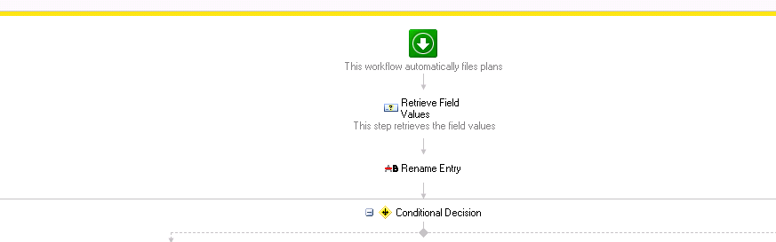

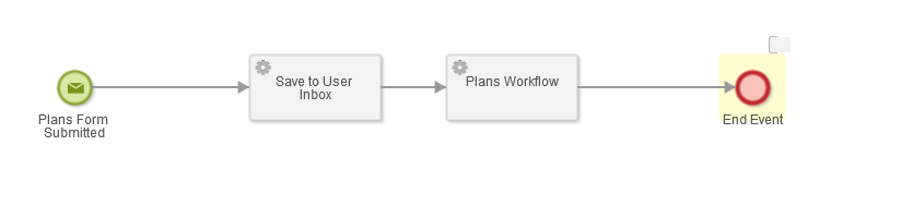

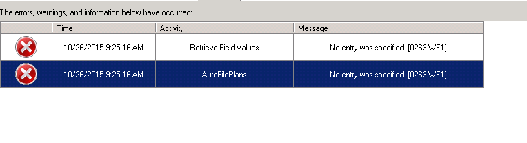

We have a two step process in forms, once the form (with attachment) is submitted it is saved to a location in the repository. Then workflow is triggered to use that entry to rename/route the entry to the appropriate location in the the repository. However we are running into an error, every time the form is submitted workflow gets an error (No entry specified). Please see attached files.

When Forms starts a WF through a service task, it does not have an entry ID to send over (because saving to Laserfiche is asynchronous). You either need to create the entry in WF or trigger the Workflow based on the document created by Forms in the repository.
