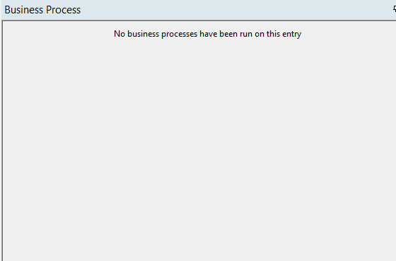

I have a workflow where business processes have been used. I am having the below screenshot on my document.

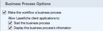

Business processes have been enabled as per below screenshot:

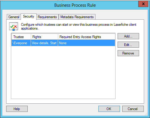

The security is set to Everyone:

Can you please advise as to why the business process is not showing on the entry?

Hi all,
I have configured the business process for a workflow. When I launched the workflow on an entry, it says 'No business processes have been run on this entry' on LF client (see 1st screenshot of my post) but in the workflow instance, it shows the various steps the workflow has gone through (see 4th screenshot of my post).
Can somebody please advise me?
