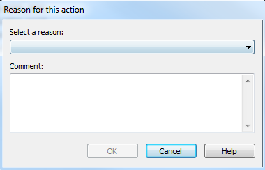

But on repo_3, I am not able to import file from any other repositories (export from repo_3 to other repositories is fine, import file from my PC to repo_3 is also fine).  I did not get confirmation asking for the import location either.  Here's the pop up I got before error message.
1] Prompt asking for reason.  There was only one item in the drop down list.

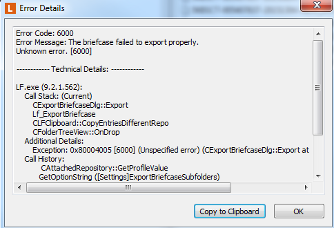

2] When I entered the reason and clicked OK, there was a pop-up error.
3] Details for error:
Error Code: 6000
Error Message: The briefcase failed to export properly.
Unknown error. [6000]
------------ Technical Details: ------------
LF.exe (9.2.1.562):
    Call Stack: (Current)
        CExportBriefcaseDlg::Export
        Lf_ExportBriefcase
        CLFClipboard::CopyEntriesDifferentRepo
        CFolderTreeView::OnDrop
    Additional Details:
        Exception: 0x80004005 [6000] (Unspecified error) (CExportBriefcaseDlg::Export at exportbriefcasedlg.cpp:602)
    Call History:
            CAttachedRepository::GetProfileValue
           GetOptionString ([Settings]ExportBriefcaseSubfolders)
           GetOptionString ([Settings]ExportBriefcaseVersionHist)
           GetOptionString ([Settings]ExportBriefcaseSignatures)
My user has effective feature rights to import/export on all repositories.
Do you know what caused the error? What setting do I need to import document from other repositories to repo_3.  Thank you

Based on the error, you are in the Briefcase export dialog not in the Import dialog.
Why not just drag and drop the file that you exported from the other repository into Repository 3 or use File > Import instead?

I did drag and drop the file like I did on the other two repositories.  I also tried copy and paste which gave me the same error.
