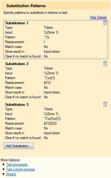

There are a few ways to make this work. One is to add the Substitution process after your ZoneOCR and add 3 substitutions (for the first 3 characters):
These substitutions look at each of the first three characters of the Invoice Number %(Zone 1) and change any 1's to I's. The "^" in each pattern marks the start of the Invoice Number, and the ${n} in the replacements preserve the nth group found in the pattern match.
For each substitution, make sure to check the "Replace the input token's value with the result" check box. This allows you to use the ZoneOCR token as you would normally.
Let me know if this works for you!
