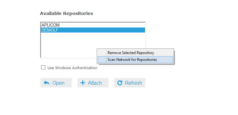

Hi,
We need to disable the option "Scan Network for Repositores" on client. How can we do it? Is there an configuration option that will do it?

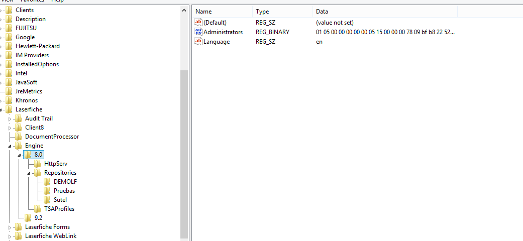

Is this for individual Client workstations or all Client workstations? If this is for all Client workstations, then an alternative is to disable the disable the Laserfiche Server broadcast by preventing it from publishing its service connection point.
Starting with Laserfiche Server 9.1.1 SP1:
You can now configure the registry to stop the Laserfiche Server from automatically attempting to republish a service connection point in order to prevent client programs from being able to automatically detect the existence of the Laserfiche Server instance. Using the Windows Registry Editor, browse to the HKEY_LOCAL_MACHINE\SOFTWARE\Laserfiche\Engine\8.0 key. Modify the value of SCPBindingPath by deleting the LDAP:// protocol prefix. (114274)
Note that in addition to making this registry change, you'd also need to remove the service connection point that may have already been registered.

Alexander, thanks for your response.
We are following the instruction, however we are kinda lost, we browsed to the indicated Key but didn't find the SCPBindingPath, and also we are not sure what do you mean by deleting the LDAP:// protocol prefix.

The scan network checkbox is controlled by a registry key, set HKEY_CURRENT_USER\Software\Laserfiche\Client8\Profile\Options\Thunk to a REG_SZ of 0.
