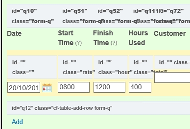

I have a time sheet form and i need to calculate the total hours.
I'm using the 24 hour format to work out the total hours. which works ok, what i need to do is display the total as single digits or double digits , eg 4 or 12 hours is there a way to do this with JavaScript ?

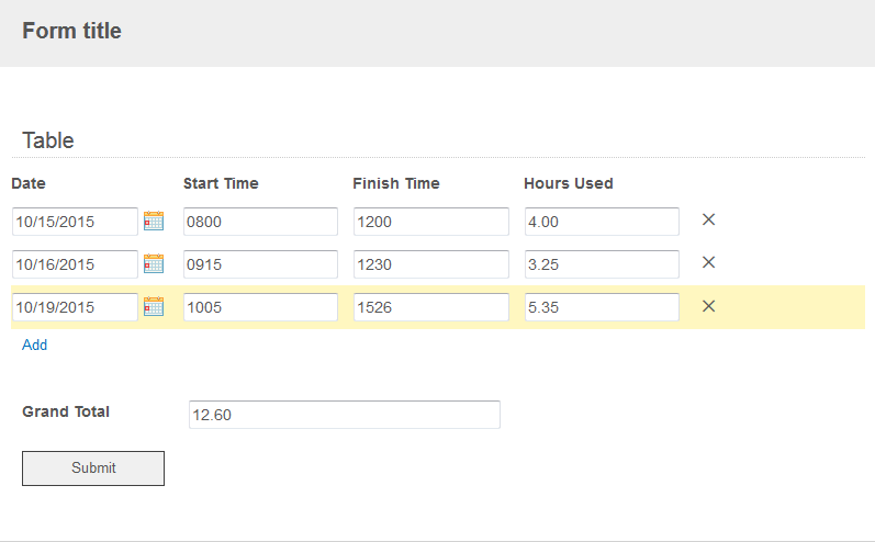

I'd recommend using external JS like moment.js for this. Then you can use the following code:
  $.getScript('http://server/Forms/js/moment.js');
  $('.cf-table-block').on('blur', 'input', sumtotal);
  $(document).on('click', '.form-del-field', sumtotal);
  function sumtotal() {
    var hour = 0;
    var rate = 0;
    var total = 0;
    var subtotal = 0;
    $('.cf-table-block tbody tr').each(function () {
      hour = moment($(this).find('.hour input').val(), 'HHmm');
      rate = moment($(this).find('.rate input').val(), 'HHmm');
      subtotal = hour.diff(rate, 'hours', true);
      $(this).find('.total input').val(subtotal.toFixed(2));
      total += subtotal;
    $('.Grandtotal input').val(total.toFixed(2));
  function parseNumber(n) {
    var f = parseFloat(n); //Convert to float number.
  	return isNaN(f) ? 0 : f; //treat invalid input as 0;
Here's a sample form
If you need to use whole numbers for the difference in hours, then you can modify the JS based on your needs, i.e. floor, ceiling, round.

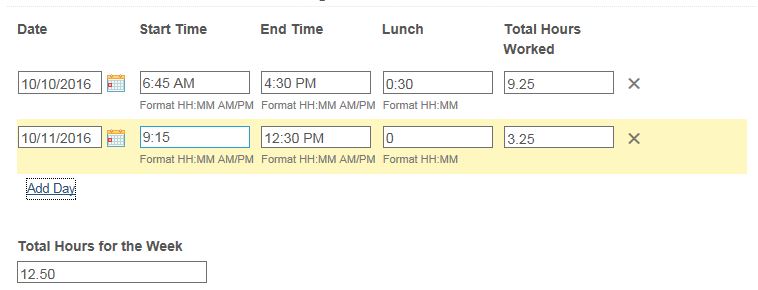

replied on October 10, 2016 Show version history
Hi,
Has anybody worked on subtracting a lunch break from the subtotal. I am trying to modify this script with no success... needless to say that I have no experience with js...
I attempted the following:
   $.getScript('http://yourservername/Forms/js/moment.js');

Subtracting lunch from the subtotal is not successful... If I substitute the var for a number it works. Any ideas about the right way of subtracting this using moment.js?
Thanks.
