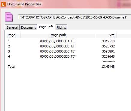

replied on October 13, 2015
Here are the stats
Capture 2.PNG (22.39 KB)

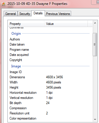

The OCR engine changed between version 8 and 9. The problem appears to be that the DPI is 1.
They normally start out with this dpi.  I just exported that image from Laserfiche.
Capture 3.PNG (5.43 KB)
