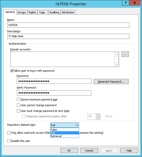

Hello,
I have configured a LF Sub-Manager to manage the allocation of Named Licenses to others users in my organization.
This Sub-Manager user has "Manage Trustees" privilege and is a Repository Full Named User.
The problem is that from his PC I cannot change the "Repository Named User" property of any user, even if I login to the Administration Console using the LF Admin user.
While from my machine I'm able to set the "Repository Named User" property to any user, both using the LF Admin account and using the Sub-Manager LF Account.
So the difference is comming from the Machine (PC) being used, or maybe from the Windows account?
Can anyone tell me what I'm missing in this configuration?

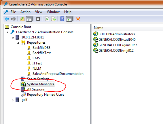

In order to allocate Named User licenses, the Domain Account that you are logged into the pc as must be setup as a System Manager in Laserfiche.
From a pc where you are actually able to allocate Named Users, open the Admin Console, and click on the System Managers node.  Make sure that the desired user's domain account is listed there.
