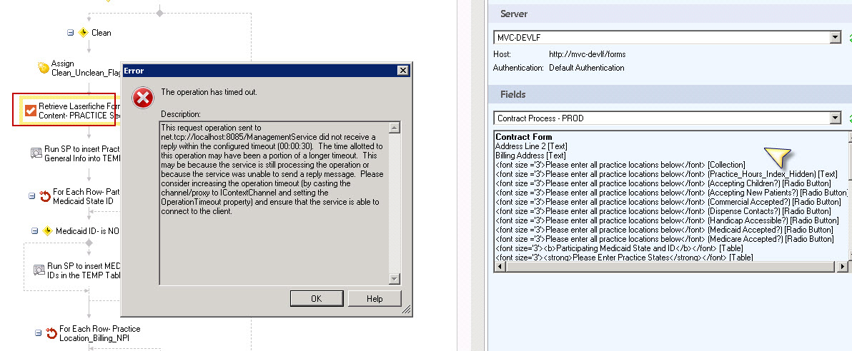

I am getting a timeout error (see screenshot) when trying to retrieve LF form values from the workflow.
Full error message is -
This request operation sent to net.tcp://localhost:8085/ManagementService did not receive a reply within the configured timeout (00:00:30).  The time allotted to this operation may have been a portion of a longer timeout.  This may be because the service is still processing the operation or because the service was unable to send a reply message.  Please consider increasing the operation timeout (by casting the channel/proxy to IContextChannel and setting the OperationTimeout property) and ensure that the service is able to connect to the client.
Please let me know how I can increase the operation timeout value??

That message indicates your Workflow Server is either not running or under a high load.

Sorry, I wasn't clear enough. I was trying to ask if you know what is going on with your server. 30 seconds is a pretty long time to wait for a repsonse.

The form that I am trying to 'Retrieve Values' from is a very big form with more than 1000 fields and lots of JavaScripts and CSS. That might be causing the time out when retrieving the values.

JavaScript and CSS are not loaded when Workflow retrieves the form fields. But 1000 fields is a lot.
In the Workflow Designer's config file (C:\Program Files\Laserfiche\Laserfiche Workflow 9\Laserfiche.Workflow.Designer.exe.config), look for a section that looks like this:
<bindings>
      <netTcpBinding>
        <binding name="ConfigurationClientBinding" transferMode="Streamed"
          maxBufferSize="1000" maxReceivedMessageSize="67108864">
          <readerQuotas maxStringContentLength="1024000000" maxArrayLength="1024000000" />
        </binding>
      </netTcpBinding>
    </bindings>
and add the following after maxReceivedMessageSize:  receiveTimeout="00:01:00" sendTimeout="00:01:00"
<bindings>
      <netTcpBinding>
          maxBufferSize="1000" maxReceivedMessageSize="67108864" receiveTimeout="00:01:00" sendTimeout="00:01:00">
        </binding>
      </netTcpBinding>
    </bindings>
You may have to try different values to see what works out for such a large form.

This solution worked for me.  I had to restart the Workflow service after making the config change.
