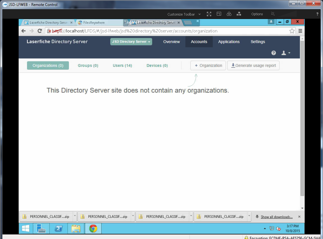

asked on October 8, 2015
I am missing the security tab , see screenshot. What causes this?

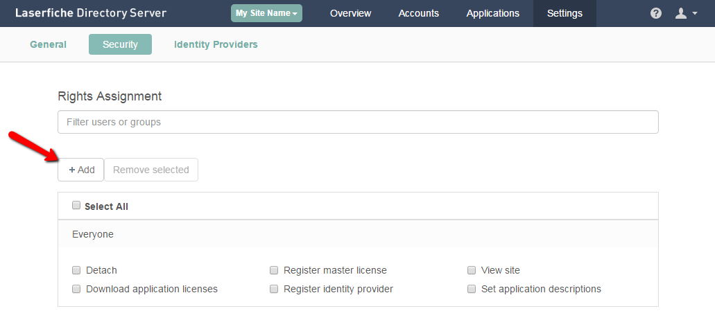

Hello Chad,
I notice you're on the Accounts view. The Security tab is under the Settings view at the top of the page. From there you can access and configure site-wide security.

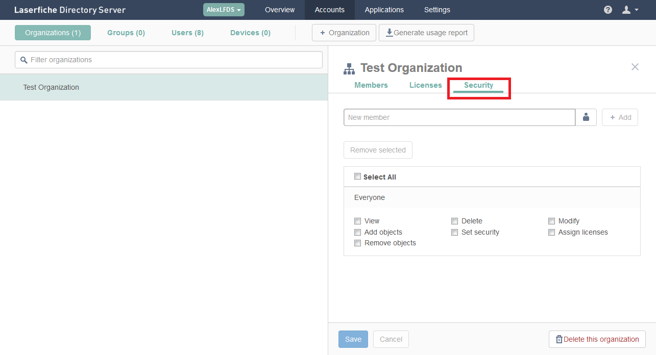

You'll need to create an organization first and then select it.
Or refer to James' response if you are talking about LFDS site wide security configuration.
replied on October 8, 2015
I want to setup another System Manager like myself. When I got to settings > security there is no one listed under there and no settings to allow for managing users, etc. Where is the System Manager's area?
replied on October 8, 2015 • Show version history
Once you create either a user or an organization from the Accounts view, you can switch to the Settings > Security tab and set their permissions. Is that what you're looking for?
Alternatively, you can create a System Managers organization and add users to that organization, then set permissions for the group of users from within the Accounts > Organizations > [That Organization] > Security tab.
As a note, the list of users on the database page is those that already have security set,  not a list of users you can add security to.
To add users:
replied on October 9, 2015
Aha, it was needing to add them to the Windows Group that I was looking for. Thank you!
