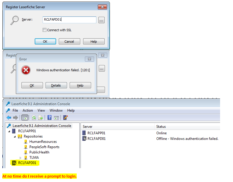

I have a customer who is attempting to register a server (RCLFADP01) on the admin console but he is getting the
"Permissions Denied 9013" windows authentication failed after selecting the server name and hitting ok.
His windows credentials worked fine with registering another server (RCLFAPP01) and work fine in the client and logging into the other server in Admin Console.
I added him as a Windows Administrator in Admin Console on the RCLFAPD01 server thinking that would help, it didn't. I also installed service pack .584, no luck there.
What am I missing?

It also does not ask him for credentials at any point.

When you get the error, please open the details button.  Copy the contents to the thread so we can see it.
replied on October 16, 2015
Error Code: 1201
Error Message: Windows authentication failed. [1201]
