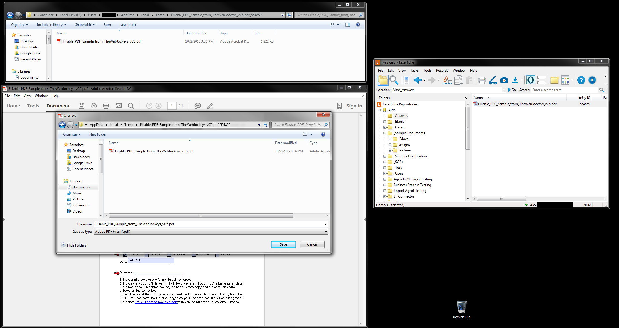

When you open the PDF from the Client in its native application (or any electronic document actually), the PDF is temporarily stored at on the workstation. By default, this path will be like
C:\Users\[Username]\AppData\Local\Temp\[DocumentName_EntryID]\
Here is an example using the PDF from this location.
The PDF resides in the repository and I have just opened it normally in its native application.

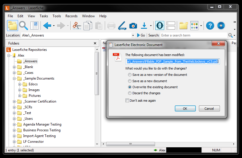

Fill out the PDF and then close Adobe Reader. You'll get prompted to save the PDF. Using the "Save As" dialog in Adobe, choose to save it back to the default location that is storing the temp copy of the PDF and use the same document name so you end up replacing the old PDF with the new one.
Once that's done and Adobe Reader has closed, you should get prompted in the Laserfiche Client about what to do with the changed PDF (that is if you haven't previously checked the box about not showing the dialog again).

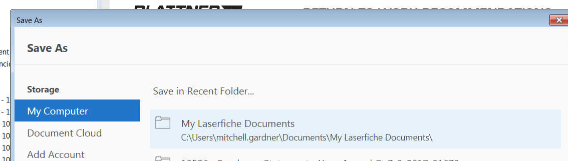

This workaround for Adobe DC is a bit tedious when compared to how editing a PDF was in XI, every file I edit with the current version of Adobe defaults to recent folders, not the "C:\Users\[Username]\AppData\Local\Temp\[DocumentName_EntryID]\" listed above. When I manually navigate the file path it saves as it should.
Seeing as how this post is nearly two years old, has there been a new solution or fix by Laserfiche for newer versions of Adobe DC that cause this behavior?

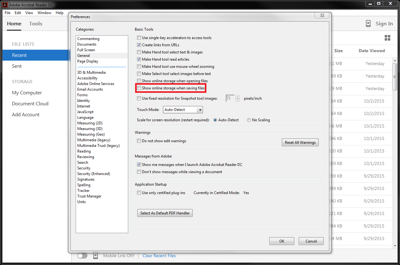

I tested and now it's working but I'm finding that I have to Browse to the location you described every time - is there someplace I can set the default path to save PDFs?
Thanks
replied on October 5, 2015 • Show version history
You can set an attribute to change the default path, however, each document still gets saved under a subfolder named with the document name and its entry ID.
The better change to make would be within Adobe Reader itself. Go into Edit > Preferences > General and uncheck the option, "Show online storage when saving files." This way when you save the PDF after making the edit, it will default to the temp folder that the PDF was opened from so you don't have to manually browse to that location.
