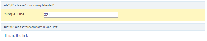

And here is an image of the two fields I'm using:
I'm trying to get it to work on this test form before putting it into the actual form... so any thoughts on why this isn't passing the #q8 input into the url? It currently opens a new tab to http://www.wherever.com?startid=

replied on February 24, 2016 Show version history
Hi David,
I think all you're missing is the on blur function to run the code when the field value is changed. Try this:
$(document).ready(function(){
   $(".num input").on("blur", function () {
       var num = $(".num input").val();
       var target = 'target="_blank"'; //Add this in to get link to open in new tab
       var link = "<a " + target + " href='http://www.wherever.com?startid=" + num + "'>This is the link</a>";
       document.getElementById("q9").innerHTML = link;
Hope this is what you were looking for!
Cheers, Dan.
