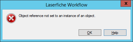

When I debug my script it says I have a reference problem but does not say which line. The message just pops up and look like this. The strange thing is if I forgot to reference anything I should be able to reproduce in Visual Studio. My code works in Visual Studio but not in the Script Editor
Update: I was able to find the line by removing one line at a time, but it would be nice to see which line it failed at.

It should be listed in the Error list pane in the script editor once you dismiss this message.
