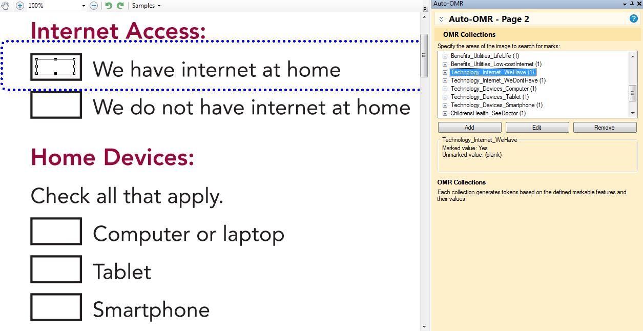

I was helping a customer fix an OMR issue. Placing the box inside the perimeter where the user should mark the form like this resolved the problem.
I can't find anything about this in the documentation though. The training videos show that the box should be around the perimeter, not inside of it. How do you know when to put the box inside and when to put the box around the perimeter.

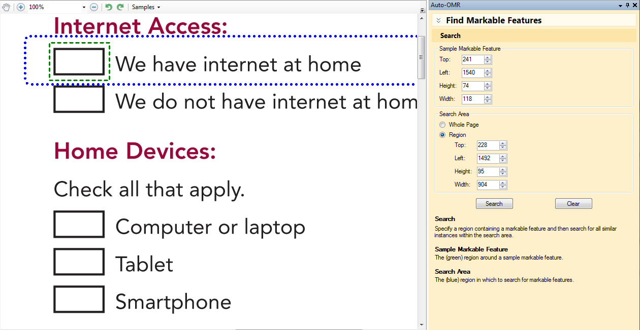

When using Auto-OMR, the green region is supposed to go around a sample markable feature and that needs to include the border of the markable feature for it to be considered valid. The point of the green region is to show what a "blank" feature looks like. The blue region is the search area which tells Quick Fields were to look for these markable features.
When it comes to actually seeing if an item is marked or not when Quick Fields processes a form, then it works best when you use the color removal process (to reduce the amount of noise on the form) and to also place that particular region inside the border so there's less chance of a false positive being considered.

I only meant to upload the one image. Where the black box is inside the perimeter of the marking area. We put our boxes around the perimeter as it is recommended by the training material. Now we are being asked to re-build all of our OMR sessions and change them to inside the perimeter. The customer would like to know why? Everything was working fine.

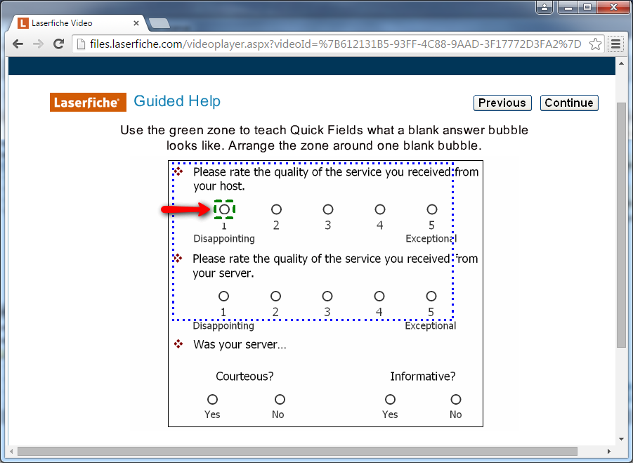

I have been submitting sessions to support because they have not been working correctly. Areas that have no marks in them are showing as marked. They are unwilling to fix the problem because they said the OMR is configured incorrectly by placing the area around the perimeter for the mark area. Look at this screenshot from the instructional video. We are placing the zone around the bubble. It seems odd that support will not assist because we are "doing it wrong".
