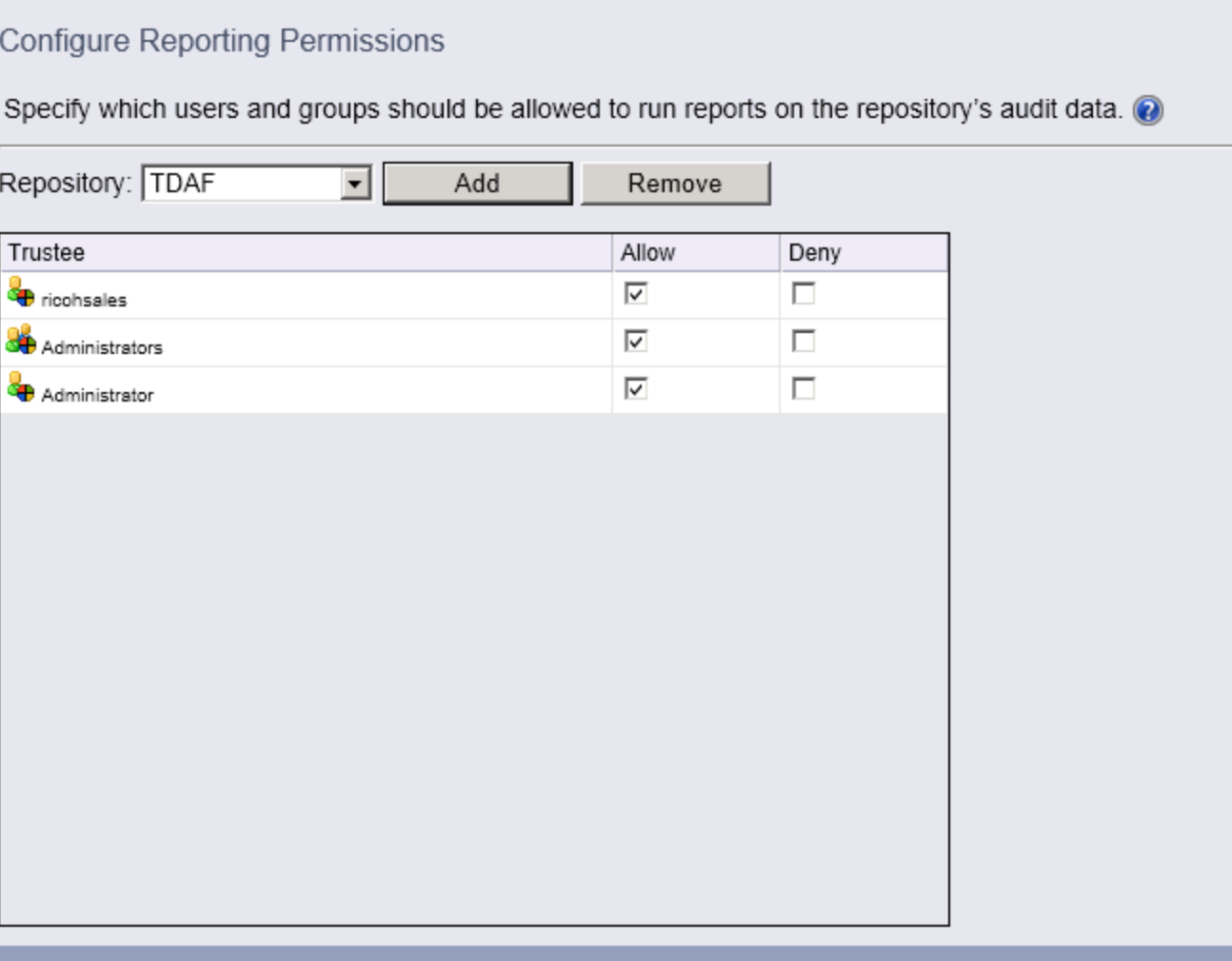

Please confirm that in the Audit Trail Configuration page's "Permissions" tab, you have granted the correct trustee rights to the repository you want to report on.
replied on September 22, 2015
That is correct please see below:
In the Audit Trail Reporting page, when you are logged into Windows as ricohsales, Administrator, or a member of the Administrators group, do you see TDAF as an available source? If not, what do you see?

The first thing you stated was correct we had duplicate useraccount names from the multiple repositories this was leading to a permission problem.
