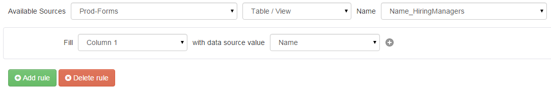

Claude,
You'll want to do this on the Lookup Rules Tab.  Follow the steps below to accomplish this.
1  Make sure Forms has access to the Database by going to the Administration Menu  in the top right-hand corner, once you're logged in as an administrator.
2.  Navigate to Data Sources and New Data Sources .  Enter the requested information and test the connection.
3.  Once that is done, you'll want to make sure the specific Form has access to see this data source.  Do this by accessing the Processes section of the page and Add/Remove the selected Forms that should have access.
4.  Open the selected form and navigate to the Lookup Rules tab to configure the lookup rule
5.  Delete the conditional and Select the Laserfiche Field you want to fill, and with what DB Field (see below).  I have found that this works best if the field is already a drop-down type field, otherwise users may not know values can be selected...
Hope that helps!
Cheers

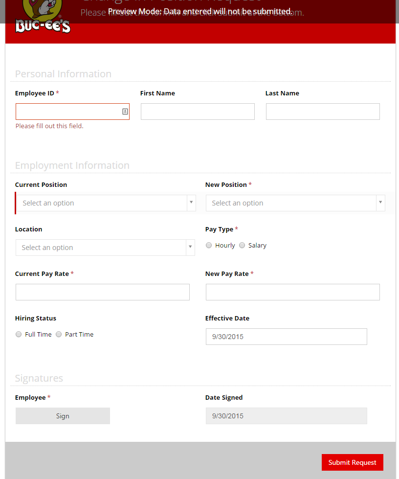

replied on September 30, 2015
Since you need a fixed number of rows, I would create multiple tables with different class names so you can reference them in code. To make them look like rows, add one more class name called "tablerow", then put this in your css file:
li.tablerow div.cf-section-header {display: none;}
You should be left with something that looks like:
At this point, it is a matter of some javascript to reference the "tablerow" tables and put your values in on the .change() events. When it comes to tables in Forms, I have had better luck using classnames to reference specific fields.
