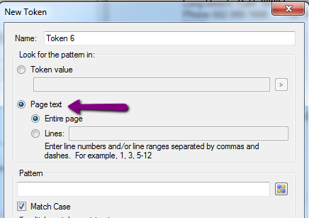

You can use the OCRed text in Pattern Matching.
The OCR engine does make some guesses based on the amount of text in the region. Try using a Smooth process as a local image enhancement to Zone OCR to clean up the characters in the region a bit and see if it make a difference. Or try setting Zone OCR's optimization settings to "accuracy".
