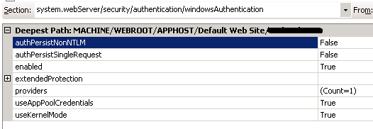

If you've registered SPNS, changed authentication to only Windows Authentication, and put Negotiate as the top provider and have the registered app pool using the correct identity (same one you set the SPNS for)....I'd suggest making sure IIS Website is set to use the app pool credentials. This is kind of a non-obvious thing to enable.
1. Open the IIS site
2. Go to Configuration Editor
3. Browse to system.webserver -> security -> authentication -> doubleclick Windows Authentication

replied on September 25, 2015
Yes it was this setting that was not properly configure, so now it works fine

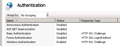

Did you verify the authentication type in IIS?

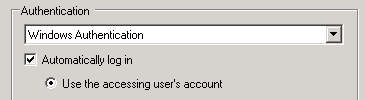

Also set Windows Authentication Method inside Weblink Administrator Utility?
