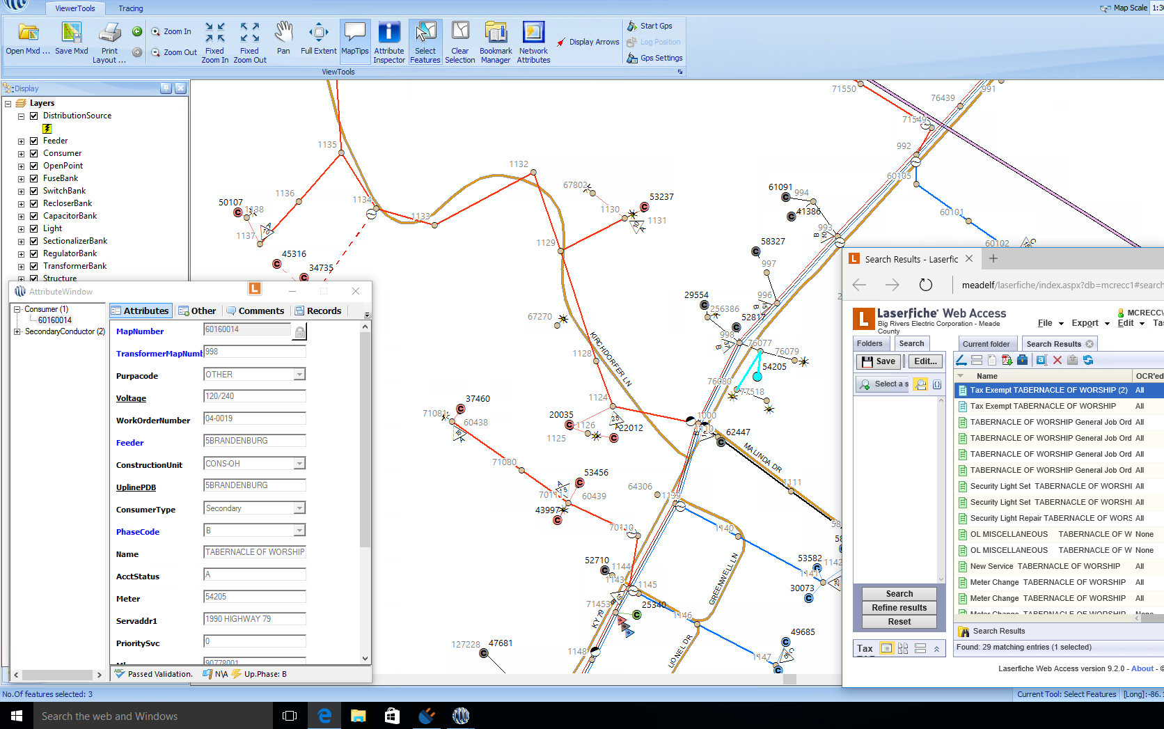

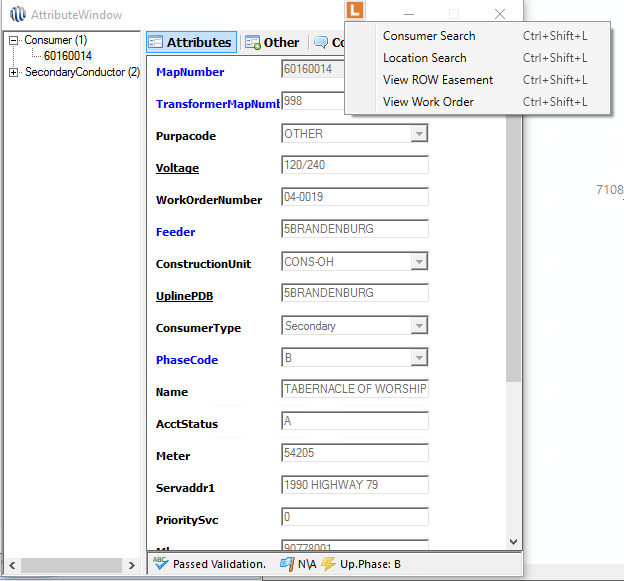

Can you provide a little more detail on how what and how you are trying to integrate ArcGIS with using Connector?  Are you using ArcDesktop or a third party application running on the ArcGIS platform?
The application which I have been able to use Connector with is Futura Mobile Desktop from Futura Systems.  This is an electric distribution utility GIS application.  Our use was for the user to be able to search the repository and return all documents based on the consumer selected as well as giving the option to search the repository for right of way easements and work orders based on the location number on the map.  I am not having Connector extract the search criteria from a layer on the map, but rather from an attributes window that pops up after the user has selected objects on the map.

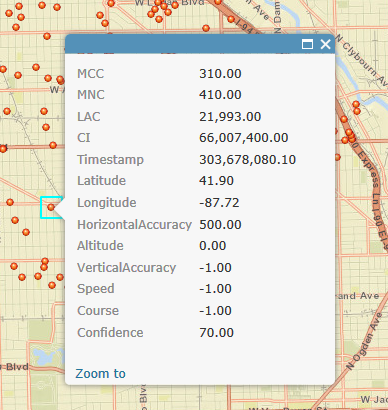

Hi Glen - working directly on the ArcGIS platform - I have Connector working with QGIS - pretty much the same as what you have setup with Futura:

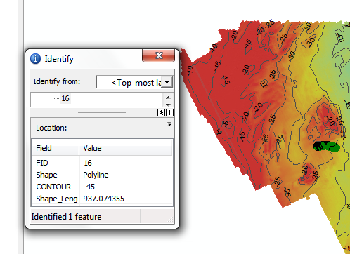

replied on September 16, 2015
Just wanted to update this – I finally had some time, so I loaded ArcReader and a sample map – I was in fact able to pull data out via the LF Connector – you just need to be able to pull up the attributes on a piece of the map (e.g. in this case I used Contour).
I was also able to get this working via AcrWeb as well – same thing – need to pull up attributes and you are good to go.
