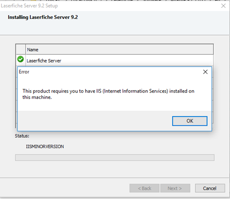

Hi All,
When installing LF audit it fails saying that IIS needs to be installed. I’ve followed the instructions in https://support.laserfiche.com/KB/1013672 but this only shows how to change the major version. It seems that the install is also looking at the minor version
What does the decimal value for the minor version need to be in the registry? All other components install ok but any web based products fail. This is the new installer downloaded today which includes SP1 for 9.2.1.

Can you confirm that you've changed the MajorVersion value to 8 at both HKEY_LOCAL_MACHINE\SOFTWARE\Microsoft\InetStp and HKEY_LOCAL_MACHINE\SOFTWARE\Wow6432Node\Microsoft\InetStp

replied on September 8, 2015 Show version history
So the 2nd issue, not being able to start the server service has magically fixed itself. Just the IIS issue now.
Also worth noting I get the same error when trying to install Forms or Web Access
Ok....I had somehow misread the KB article to be 18 not 8. Changed it to 8 and all works OK now. Cheers Alexander!
No worries, Chris. smiley
