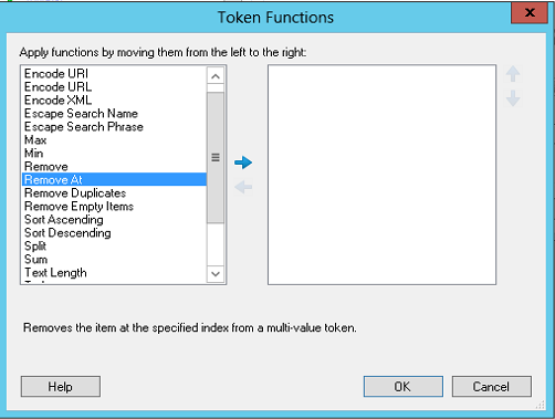

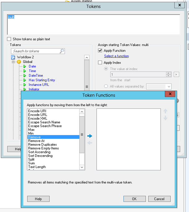

If the values are specific names not used elsewhere, you can use the "remove" function.
If you keep a 2nd token updated with a list of the index position of the starting tokens, you can use "remove at" to remove that index location from the first token.

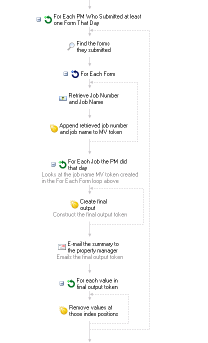

Hi Chris,
I tried that already, and it works during the first two iterations, but then starts to fail.
The scenario is as follows: property managers visit multiple properties a day and submit a "property visit form" from each property. At the end of the day, a workflow will run and send a daily report to each property manager summarizing the work they have done that day.
Here's the part of the workflow that has the issue:
The final output will go into an email body and have this format for each property manager:
Submitter: Property Manager's Name
Job number: 1
Job name: test1
Job number: 2
Job name: test2
Job number: 3
Job name: test 3
I'm testing this workflow on a batch of six forms. Bob has one form (and one job name/job number), Denise has two, and Jack has three.

But then Jack gets this email:
Submitter: Denise
Job number: 2
Job name: test2
Submitter: Jack
Job number: 3
Job name: test3
Submitter: Jack
Job number: 5
Job name: test5
Submitter: Jack
Job number: 6
Job name: test6
Submitter: Jack
Job number: 6
Job name: test6
This email has not only the wrong number of jobs (should be three instead of five), but also has Denise's job info as the first group. Then in the second group, the submitter changes to Jack, but job number and job name are still Denise's.
It's almost as if the internal For Loops go out of sync with the external loop after the first few iterations.

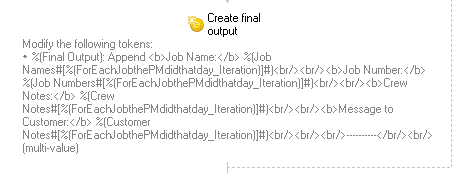

For more information, would I also be able to see how the "Append retrieved job number and job name to MV token" and "Create final output" activities are set up?
replied on September 4, 2015

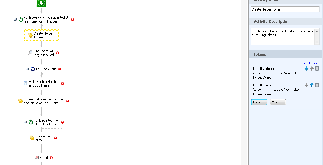

I think Winston was asking for the entire flow because it sounded like you had nested loops. The easiest way to handle that would be with a helper token that you create in the inner loop so it starts off clean at each iteration, then append to the main one at the end of the iteration.
Thanks Miruna. Do you mean attach the workflow here? I've attached Forms business processes before but they were removed by Laserfiche staff, which is why I've been posting just screenshots. If it's OK to attach .wfx files I can do that.

Hello Ege,
Miruna is correct that a helper token would work and based on the workflow screenshots that were given. Would this setup work in your case?
This would create the job number and job name tokens each time the loop begins since those are the ones that get overwritten each iteration. Each time they are created, they will start off clean.
