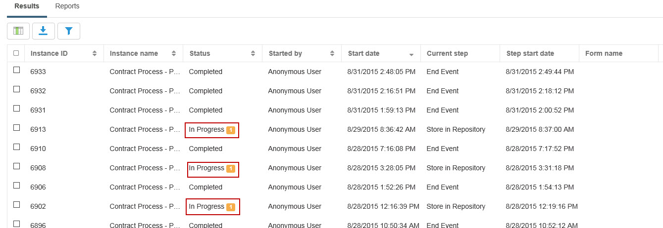

We have a process that uses a VERY big form (more than 1000 fields and lot of custom JS).
Some of the forms (not all) are getting stuck after submission. I checked in the Form's Results, and around 10% of forms are getting stuck. When I re-run them, they submit and come to repository with no issues.

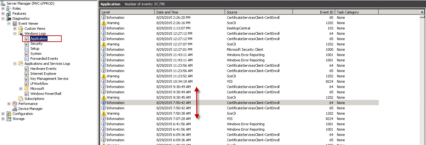

I checked the logs and I don't see any issue during the time it shows the form got stuck.
Please let me know what can be the reason for this. I am not sure if I am looking at the right place for the logs. Please let me know if I need to look at somewhere else to identify the real problem.
Please see screenshots below.

Here are the attachments.
In Progress.jpg (102.6 KB)
Error Log.jpg (155.52 KB)

Hi there,
Is your event viewer UTC time? Can you retry the suspended service task, and see whether there is error logged?

After retrying the suspended jobs, they are completed successfully, with no issues.
