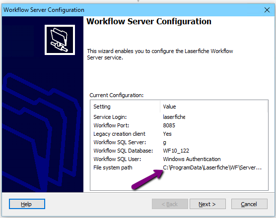

  2. Open Workflow Config Manager on the old server and take a look at where the WF volume is stored

  7. Configure WF on the new server and point to the SQL DB used by the old WF Server (adjust the volume path to point to the new location if necessary)

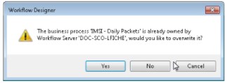

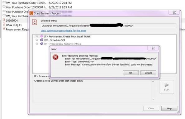

I just had a client contact me that I moved their Workflow server to its own server by following your steps above, but they are having issues with published Business Processes. Here is the error the end user is seeing from the Client:
If we go into Workflow and try to republish that Business Process, we receive the following message:
If they say yes it fixes the previous mentioned error for the end user. Is there another step that we should have done to prevent this from happening?
replied on August 27, 2019
Good point. Yes, you do need to republish business processes.
