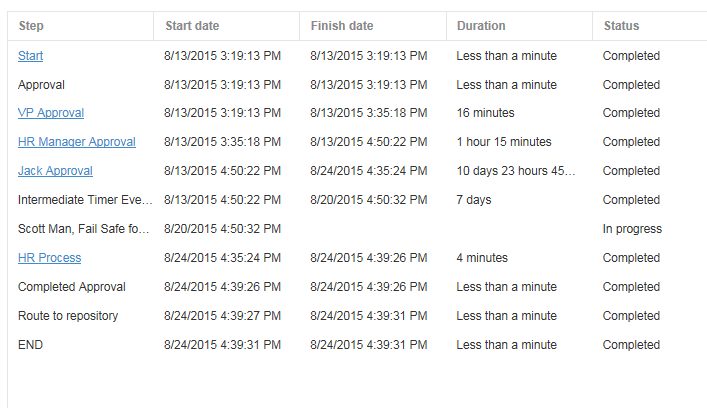

With some of our processes we have timers set up to remind people to fill out a form. One of the issues we've seen is that when the timer is set off and the form that is sent to remind them is filled out, the process will be completed but the project stays in the Process Modeler and doesn't leave the inbox.
Here is an example of the inbox showing the process as complete, but because the initial email sent, (before the timer), wasn't filled out the process doesn't leave the inbox.
I'm just wondering is there something to add to the process modeler that can make a stop marked as complete if the process moves on?

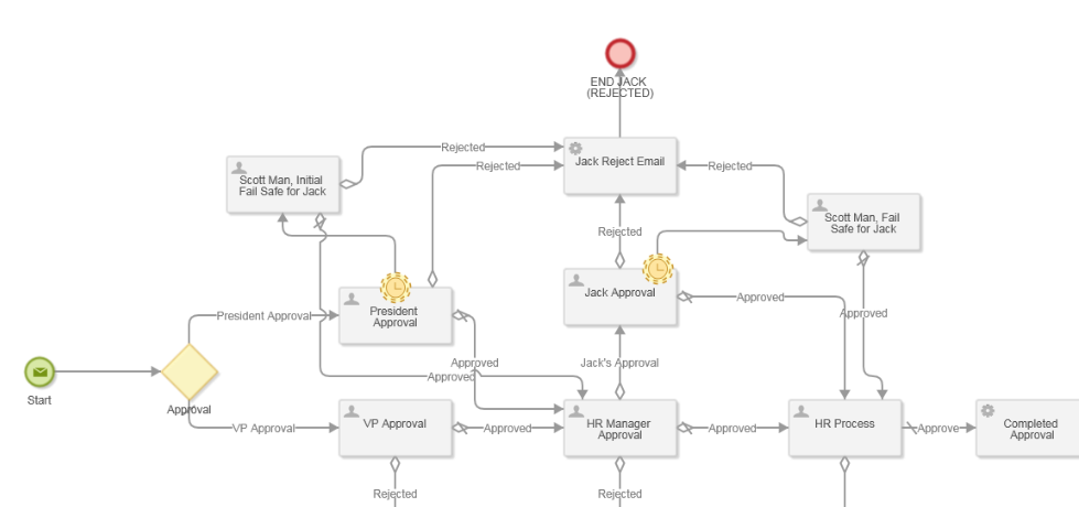

Can you attach a copy of your process modeler?
replied on August 27, 2015
Here's a screenshot of the process. Each timer will go to the HR manager in case the president doesn't get to it in time.
I'm guessing that this is happening because on the timer settings you have not told it to Interrupt the Attached Activity. Can you check and see if that has been selected in your timer activities?
