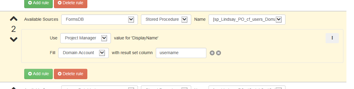

I am now having an issue where the value I return to a Field from the above code I need to use:
1. In a LookUp Rule where I have multiple lookup conditions so Forms automatically adds a radio box. I used the fix (which I have used before with success) the following code to automatically check the autofill box.
   function autofill() {
    $('.autofill').trigger('click');
  $('.lookupCondition').change(autofill);
"or"
Alternately which often I do now I create a stored procedure to perform the lookup conditions I want and pass the value of a Field returned from the above Patten Match code.
However neither is working. It seems as if due to the fact that I am passing the value to the Field via JavaScript the returned value is not being recognized as I have used both the autofill and stored procedures with success in other instances.

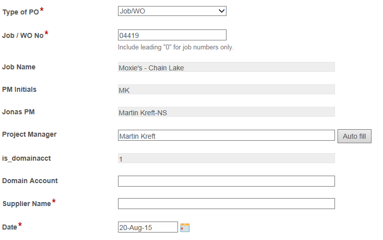

replied on August 20, 2015
No Pattern Match portion works fine.
I pull a value from a database that looks like 'John Smith-NS'.
I fill a field using the Java Script called Project Manager with the value 'John Smith' as a result from the Java Script code.
However I now want to use the Project Manager Field as a variable in my Stored Procedure to lookup the Username from cf_users. So I pass Project Manager as the displayname using a variable in my stored procedure and the value of '1' for is_domainaccount to return DOMAIN\jsmith. I tested my stored procedure and it works fine ( I actually use others on this form that work like a charm) but nothing gets returned to my Field called Domain Account. It seems like when I pass the Project Manager Field which is displaying 'John Smith' no value is being passed to the Stored Procedure.

ALTER PROCEDURE [dbo].[sp_Lindsay_PO_cf_users_DomainAccount]
@DisplayName varchar(50)
AS
BEGIN
SELECT *
FROM [Lindsay_LFForms].[dbo].[cf_users] where is_domainaccount = '1' and displayname = @DisplayName
END

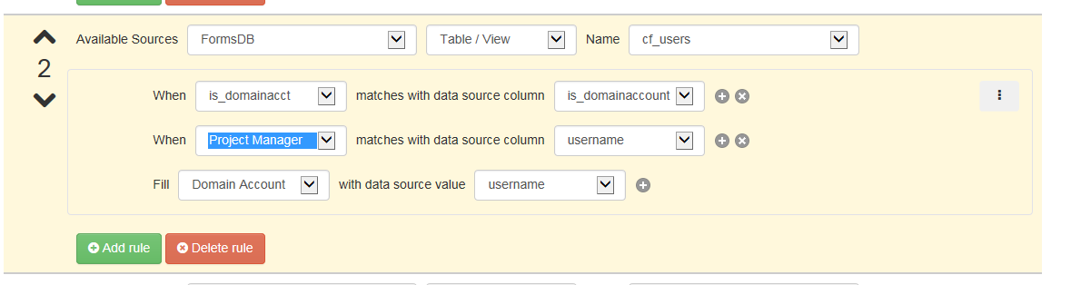

So instead I thought I will just do a normal LookUp Rule
I now get an autofill box. So I use the code and assign to CSS class to have the autofill box automatically click.
This works elsewhere on other forms however my Domain Account in this case will not fill in until I manually click the autofill box.
I thought perhaps the reason neither of these are working is because I am populating the Project Manager field using JavaScript so the value is not being recognized as there has been no click, blur or any other event.
Optimally I would like to use the Stored Procedure as it avoids the autofill button and hidden fields but just find this strange as I have done both SP and Autofill before without problems the only thing different is the field is being populated as the result of JavaScript.
