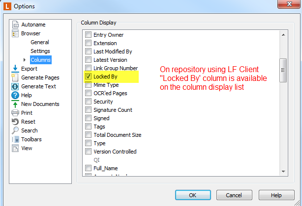

On repository using LF client I can right click on column heading and select "Locked By" from column display to display this column.  But I cannot find the option to display this column on Web Access.  Does anyone know how to do this or where this column is on Web Access?  Thank you.

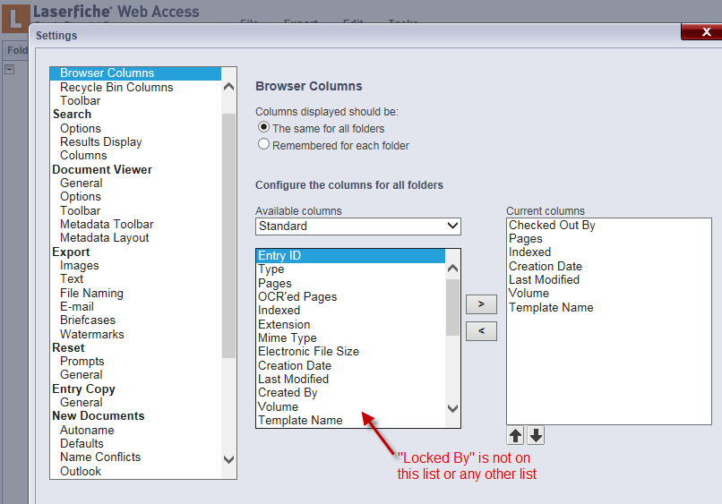

I mean can this be configured on Web Access?  The settings under browser columns on Web Access does not have 'Locked By' in the available column for me to choose.  I tried to do this using LF client and it displayed Locked By column, but when I used Web Access (with different browser and/or cookies deleted) the column still does not show up.

You are correct that the Locked By column is not currently available in Web Access. In addition to being a column in the desktop Client, this information is available in the administration console. Is there a specific reason why you want end users to be able to view the user that has the entry lock?

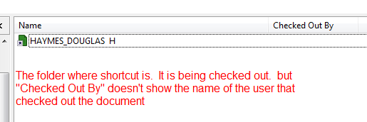

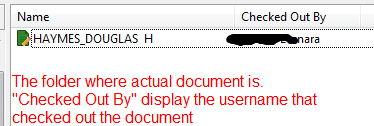

Hi Justin,
We have a folder that contains shortcuts.  The user right click on shortcut and check out document.  When this happens, the actual folder that document resides displays the name of the user that checked out the document under "Checked Out" column. But on the folder that contains shortcuts, there is no display that other user has checked out this document.
Is it possible to have the "checked out by" display the name of the user that checked out document in the folder that contains shortcut?
Folder that contains shortcut
Folder that contains actual document
replied on August 21, 2015
I also noticed that some users can see the name in "checked out by" on shortcuts, but some users can't.  Is there a permission or access that I have to set for this to be visible to all users?
