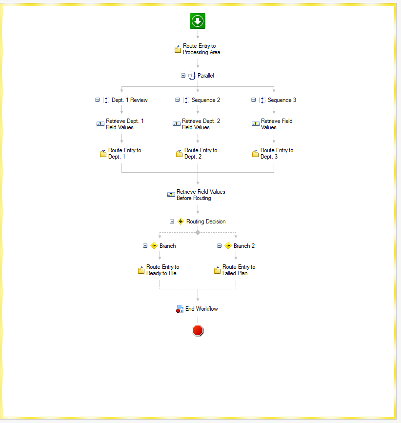

I have been working with our local solutions engineer on developing a workflow for a permit approval process and have been running into issues with Laserfiche Workflow not recognizing when metadata has been change to approve the review of a document. The workflow that we've set up works on the Solutions Engineer System but does not work on ours. We've ensured that each workflow task is pointed to the proper source (ie: original document or the routed document). We've also confirmed that the user initiating the workflow has full access rights for the folders and the template.

Does this workflow start off of a metadata change or is the metadata change you are talking about come from the route entry?  Depending on which it is I would either add a screenshot of your starting rules or I would go into the description options and show summaries so there is more information on the tasks.
