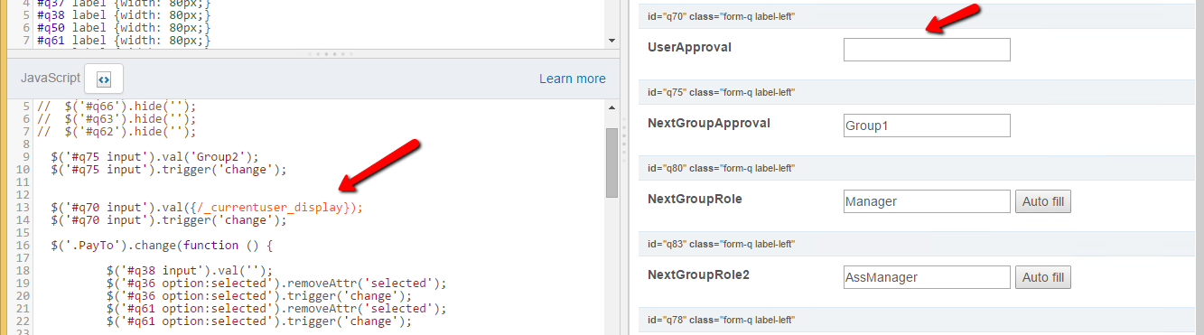

      Did anyone ever have an experience with assigning the {/_currentuser_display} variable to a single line field in javascript page like this ?
  $('#q70 input').val({/_currentuser_display});
  $('#q70 input').trigger('change');
I tried to do this but it didn't work.

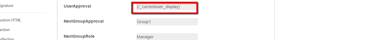

I would like to use the same account field for all forms through business process modeler so I set {/_currentuser_display} instance as default to the account field of  first form and then changed value of this field in javascript page of each form.

You can use the {/_currentuser_display} variable to populate a field, as shown in your screenshot. However, you cannot directly use the token in your JavaScript, it is not parsed by Forms.
