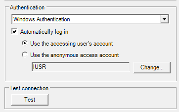

In a more concise way, something has to authenticate or log in to view a document regardless of the URL or using WebAccess or Weblink.
If using weblink, in the weblink administrator utility you must setup a directory to:
a. Use automatic windows authentication (which passes through the browser making the request)
b. Use a singular laserfiche account to anonymously authenticate everyone (configured to consume the public portal license)
The windows authentication method is also able to be set to automatic for Web Access. Again, depending on your network, Kerberos may be required. Laserfiche has produced some white papers on how to set that up too.
Then you can pass constructed URLS either by document ID, or populating a URL which returns a search query, to view documents without requiring the user to manually login.
