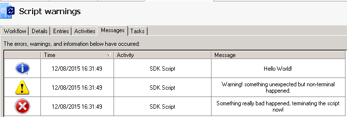

replied on August 12, 2015
You can record messages in the instance details at runtime by using the WorkflowAPI. Look at the TrackInformation, TrackWarning and TrackError methods.
        protected override void Execute()
            // Write your code here. The BoundEntryInfo property will access the entry, RASession will get the Repository Access session
            WorkflowApi.TrackInformation("Hello World!");
            WorkflowApi.TrackWarning("Warning! something unexpected but non-terminal happened.");
            WorkflowApi.TrackError("Something really bad happened, terminating the script now!");
4 0

The caveat being to make sure you comment out or remove non-essential message tracking when you move to production as these messages are stored with the workflow.
Because Workflow runs as a service, it has no UI.
The method Miruna points out is the preferred way because it will give usable information not only during development and debugging but also in the production environment allowing for faster troubleshooting of process breakdowns.
Thanks you two!
Marking Miruna's response as the answer just because it seems like it would be a better solution for debugging purposes.
