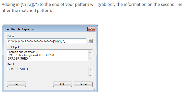

If you are trying to capture the Miami Shores line for your field in the QF session, then try pattern matching.  Someone helped me last week to get the second line captured for my field.
https://answers.laserfiche.com/questions/81728/pattern-match-to-capture-what-is-after-a-string-in-the-middle-of-a-string
Thanks to Carl!
