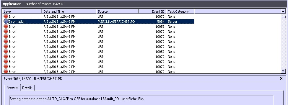

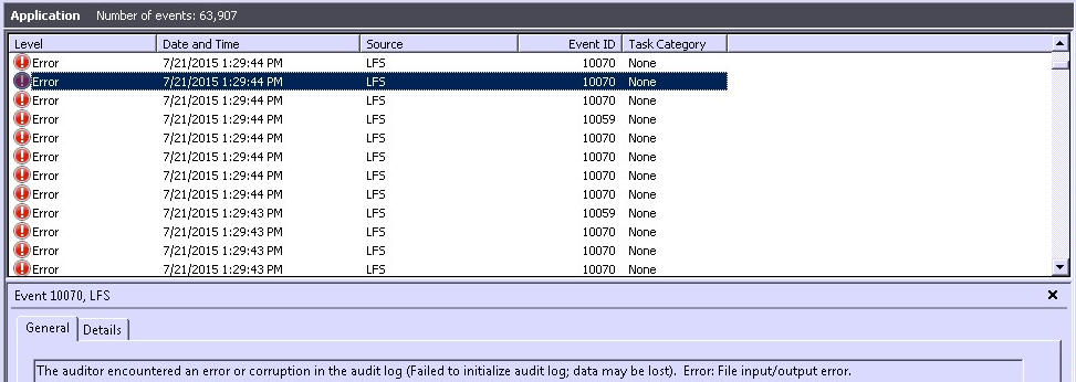

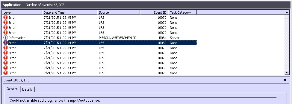

We keep getting a "could not enable audit log" error. Does anyone else have any experience with this or know how to fix it?

What's the exact version of the Laserfiche Server being used?
Make sure that the Laserfiche Server service account has read/write permissions to the Audit Log path (path listed in the registry for the AuditLog dword under HKEY_LOCAL_MACHINE\SOFTWARE\Laserfiche\Engine\8.0\Repositories\[Repository_Name]).
If the path is valid and the Laserfiche Server service account has the necessary rights, then navigate to the path and backup the [Repository_Name].log file. Then delete that file from the AUDIT folder. Restart the Laserfiche Server service and see if it starts up properly and if users can log into the repository.

I know this is an old post, but I encountered this issue today and your suggestion fixed my problem. Thanks.
