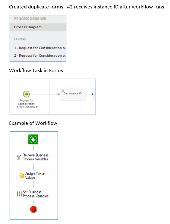

replied on February 26, 2021 Show version history
Wanted to provide a sample of the process that is working for us here (also wanted to say thank you!):
