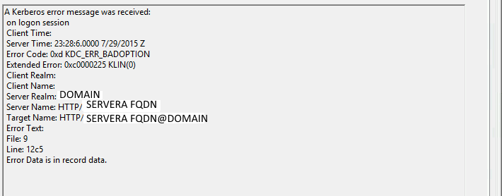

I am able to login with Kerberos from the machine with Web Access(ServerB) without issues using both a FQDN as well as just the hostname. When I attempt to login from the Laserfiche server I receive a 9013 error in WebAccess and a plain permission denied from Weblink. I have enabled Kerberos logging, and whenever an account is not allowed login, I get a KDC_ERR_BADOPTION error logged in event viewer shown as attached.

I think you'll want to do: "setspn -A http/ServerA ServerA" and "setspn -A http/ServerAFqdn ServerA", as long as you have enabled kernel-mode authentication.  If you haven't read the white paper on configuring kerberos for Web Access you should take a look at it.

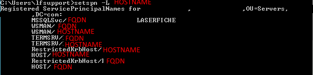

How are Server A's HTTP SPNs registered?  Is the virtual directory set up to do kernel-mode authentication (Authentication | Windows Authentication | Advanced Settings...)?
replied on July 31, 2015
There are no HTTP SPNs registered on server A. What should I need to register for when running the server as localhost? I ask because we will need to involve their IT for this and would prefer to have a command in mind ahead of time. I think just SETSPN -R http/hostname would be right, but I would like confirmation ahead of time if possible.
There are HTTP SPNs on server B either if that matters.
Everything is setup for default in kernel mode still.
replied on August 10, 2015
This worked, thank you.

This one tends to work for me:
setspn -A HTTP/<FQDN of Laserfiche service server> <host name of server service>
setspn -A LaserficheServer/<FQDN of Laserfiche service server> <host name of server service>
setspn -A HOST/<FQDN of Laserfiche service server> <host name of server service>
