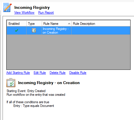

replied on July 29, 2015
Hi Miruna,
This is the starting rule for the workflow:
replied on July 30, 2015
Starting rule says, when entry created.
Your description is for entry Changed.
If you fill the data when you create Document, it will work.

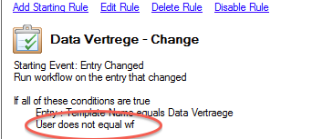

The user you use as connection profile, in my screenshot the user is called wf & I exclude it in Rule.
The idea is that if this user is not excluded from the starting rule, then every change will be considered a starting point because even this users change is evaluated as change & it will go in an endless loop.

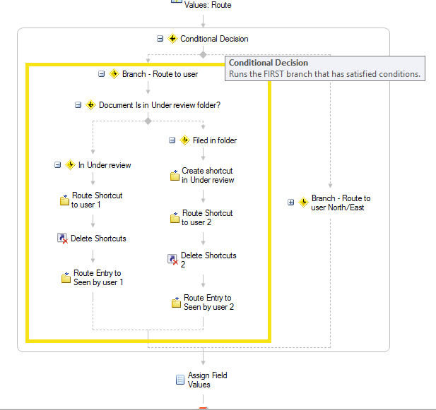

replied on August 10, 2015
Hi all,
I have added the starting rule for Entry Changed in my workflow and each time the entry is being modified, it is creating more than one shortcut in a folder and email is being received more than one times. Please find attached screenshot of my workflow.
Can you please advise on how to avoid many shortcuts being created and email being sent several times?
Thanks
Kind Regards,
Sheila

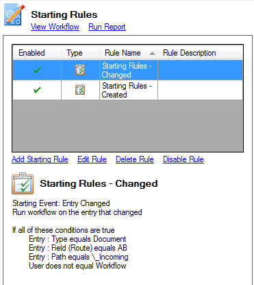

replied on August 20, 2015
Hi Sheila,
If I'm understanding correctly, it sounds like you want a workflow to make a shortcut of a document when a certain piece of metadata contains the value "AB".
If so, then here's one way to accomplish this task:
The first thing to consider is when do we want to make this shortcut?  I can think of two possible scenarios:
  1. A user fills in the metadata when scanning a document into the repository.
  2. A user changes the metadata on an existing document.
Therefore, we'll want to make sure our workflow has two starting rules:
  1. When a document is created.
  2. When a document is changed.
For example, where what my two starting rules look like:
The first rule is checking to see:
  1. If a document was created.
  2. If that document has a field Route with value AB.
  3. That it's created in the _Incoming folder.
  4. And the user who created the document isn't Workflow.
The second rule is checking to see:
  1. If a document has changed.
  2. If it also has a field Route with value AB.
  3. That the document is in the _Incoming folder.
  4. And the Workflow user wasn't the one who changed the document. Like Sahil mentioned, this helps prevent loops since it won't worry about documents that Workflow has changed.
And that's it!  Now our workflow should only be running when a document has met the conditions above, and so we're only making shortcuts when we need to.
