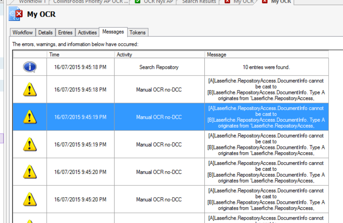

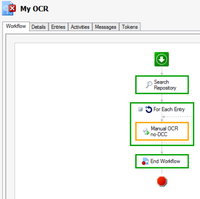

Now as far as I have got I made a simple workflow to call the OCR script but it is failing and I think it might be the way that the authentication is happening with the current version of Rio I am running 9.2.1 and where the script came from.
Can anyone have a stab at what is going on here for me and suggest how I could improve my approach, fix the code or start again with something else?
Here is the script and attached are the pics that may help start the troubleshooting if anyone has bothered to read down this far into my ramblings :)

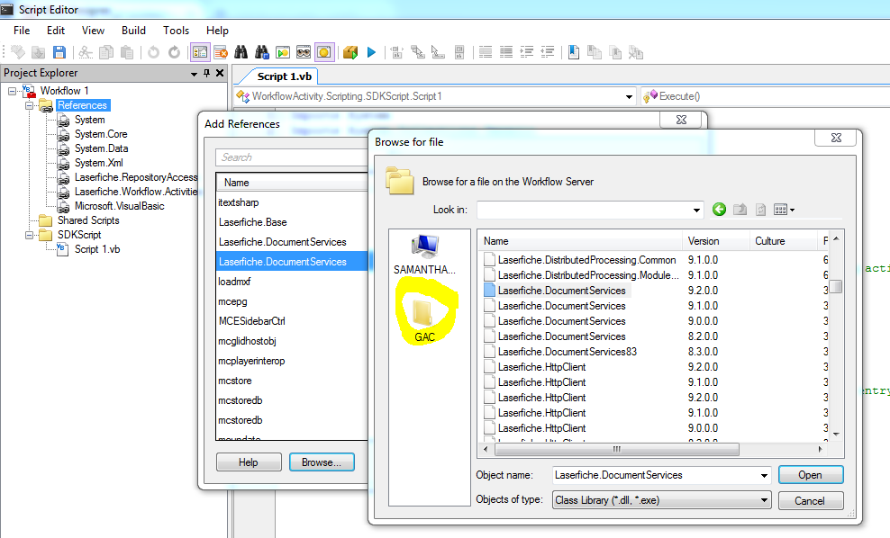

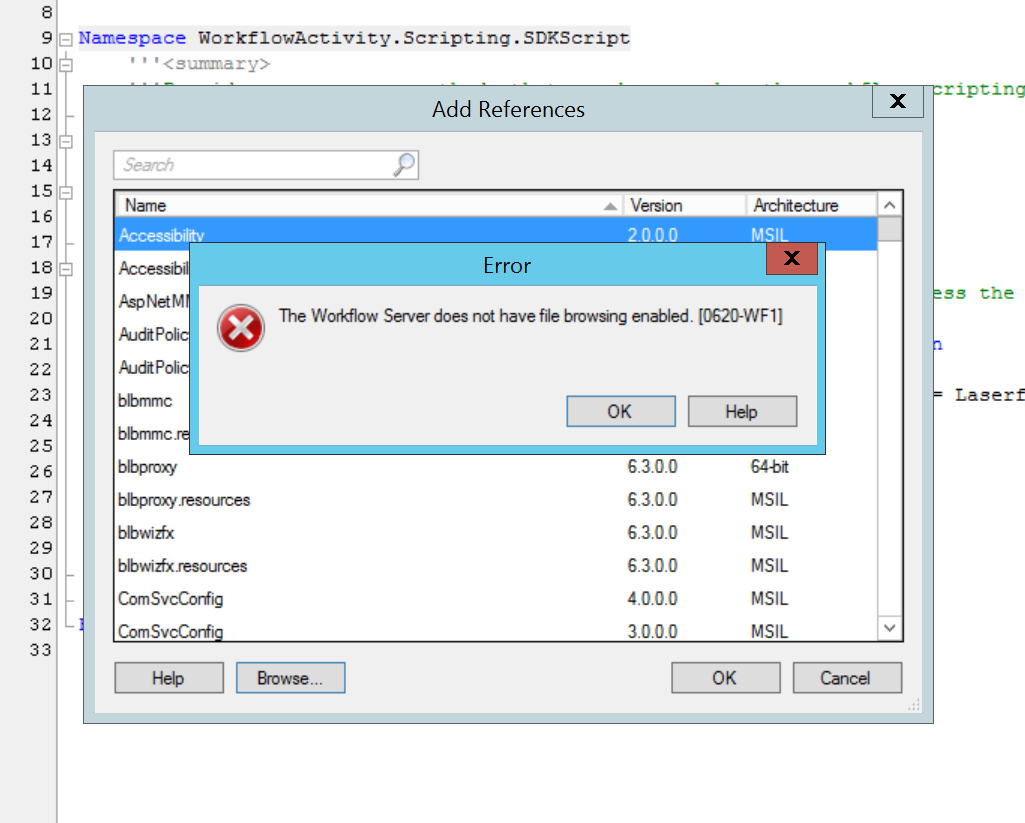

File browsing is turned off by default on the Workflow server.  To enable file browsing start the Workflow Admin console, open the 'Security' node, and double-click on the 'File Browser Options';
Make sure the 'Global Assembly Cache' (GAC) is checked as we might need to actually browse the GAC to find the DirectoryServices assembly.
When you try to add the DirectoryServices assembly from the SDK script activity click on the 'Name' column to make sure the assembly names are sorted in alpha ascending order then look for the 'Laserfiche.DocumentServices' assembly.
If you do have to 'browse' to find the DirectoryServices assembly then select the GAC (Global Assembly Cache) option.
Since you have a 9.2 Rio system you will find the 9.2 version of the DirectoryServices assembly as it is part of the Laserfiche Rio server installation. (Again make sure to click on the Name column header to make sure the entries are sorted in alpha ascending order)

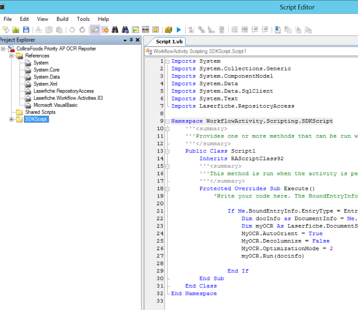

Will - As far as the script is concerned; yes the problems you are running into is that you are trying to run an older script on your system.  Here is a 9.2 SDK script that works on my VAR kit Avante system.
Imports System.ComponentModel
Imports System.Data
Imports System.Data.SqlClient
Imports System.Text
Imports Laserfiche.RepositoryAccess
Namespace WorkflowActivity.Scripting.SDKScript
    '''<summary>
    '''Provides one or more methods that can be run when the workflow scripting activity is performed.
    '''</summary>
    Public Class Script1
        Inherits RAScriptClass92
        '''<summary>
        '''This method is run when the activity is performed.
        '''</summary>
        Protected Overrides Sub Execute()
            'Write your code here. The BoundEntryInfo property will access the entry, RASession will get the Repository Access session
            If Me.BoundEntryInfo.EntryType = EntryType.Document Then
                Dim docInfo as DocumentInfo = Me.BoundEntryInfo
                Dim myOCR As Laserfiche.DocumentServices.OcrEngine = Laserfiche.DocumentServices.OcrEngine.LoadEngine()
                MyOCR.AutoOrient = True
                MyOCR.Decolumnize = False
                MyOCR.OptimizationMode = 2
                myOCR.Run(docinfo)
            End If
        End Sub
    End Class
End Namespace

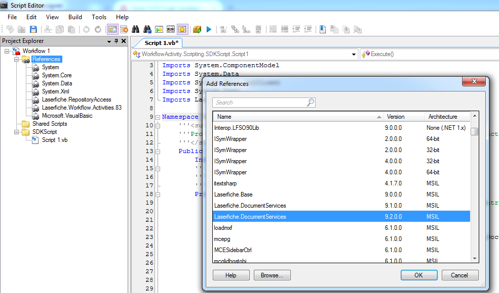

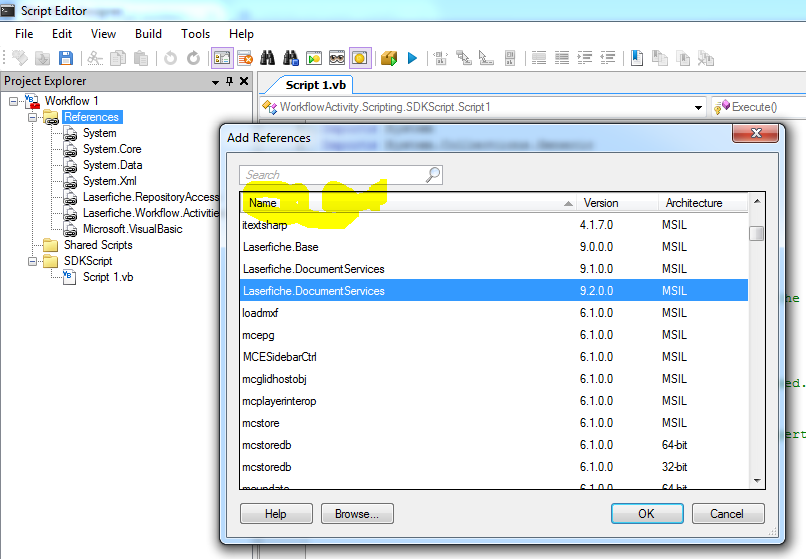

Drop a brand new SDK Script activity in your workflow and copy _only_ the code between the  'Sub Execute()' and the 'End Sub'
In order to reference the DocumentServices routines you will need to add the appropriate reference.  Here are some screen shots;
Right mouse click on the 'References' node in the Project Explorer, select 'Add Reference'
In the list presented look for the appropriate version of the DocumentServices assembly (9.2 in this case) and click OK
You should now be able to execute the script on a document to test it.
Let us know if you continue to have problems...

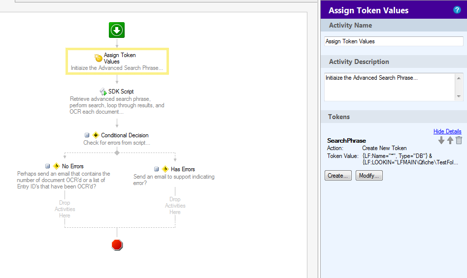

Some additional thoughts;
I would assume that running OCR on documents from Workflow is going to have a negative impact on Workflow system performance.  Therefore, if you are going to use this approach I would try to make it as efficient as possible.
One option would be to run the entire search, loop through results, and OCR in a single SDK script entry.
My assumption is that there is some overhead in loading and unloading the OCR engine and even though it will get cached it would be more efficient to load it once and run it against a series of documents instead of loading it for each document to OCR (As your current approach is going to do).
Maybe something like this;
If you think this has merit I can code up a script that will accomplish this for you...

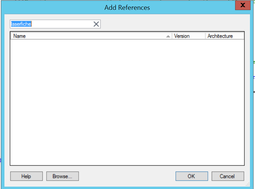

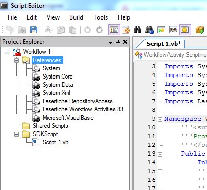

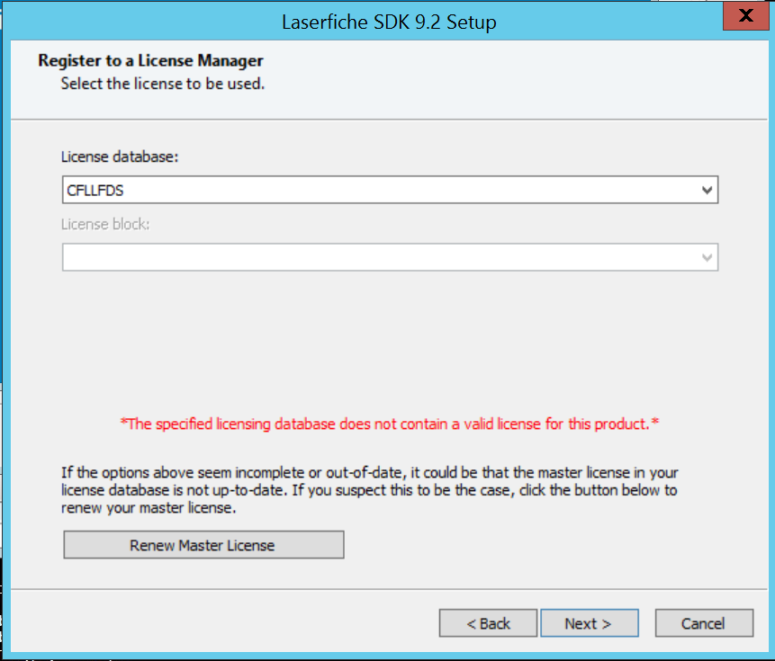

I've run into another obstacle - it looks like the 9.2 SDK is not properly installed - although the Runtime instance was installed earlier.
When I run the 92. SDK installer and it gets to the Licensing Block allocation even when I do a renew master license it never provides a block to install it.  I get an error stating that this license does not provide for a valid license block.  Pic attached.
The reason I'm digging in this direction is that I can't see any assembly instances in the Script Editor like you showed me to identify so I assume it is because the shared libs are not installed.
And I can't browse to boot...  Nowhere I can see to configure allowing broswe the tree.
Probably I can hook onto one of the existing instances right?  I might try that now but I would like to understand why Rio can't add SDK - its not a product constraint is it?  Extra $$$s?
So, do I need the SDK at all or am I barking up the wrong tree?

Awesome, so now it is properly assembled with its dependencies.  I will hook together a simple test workflow to call it and see how it goes.
